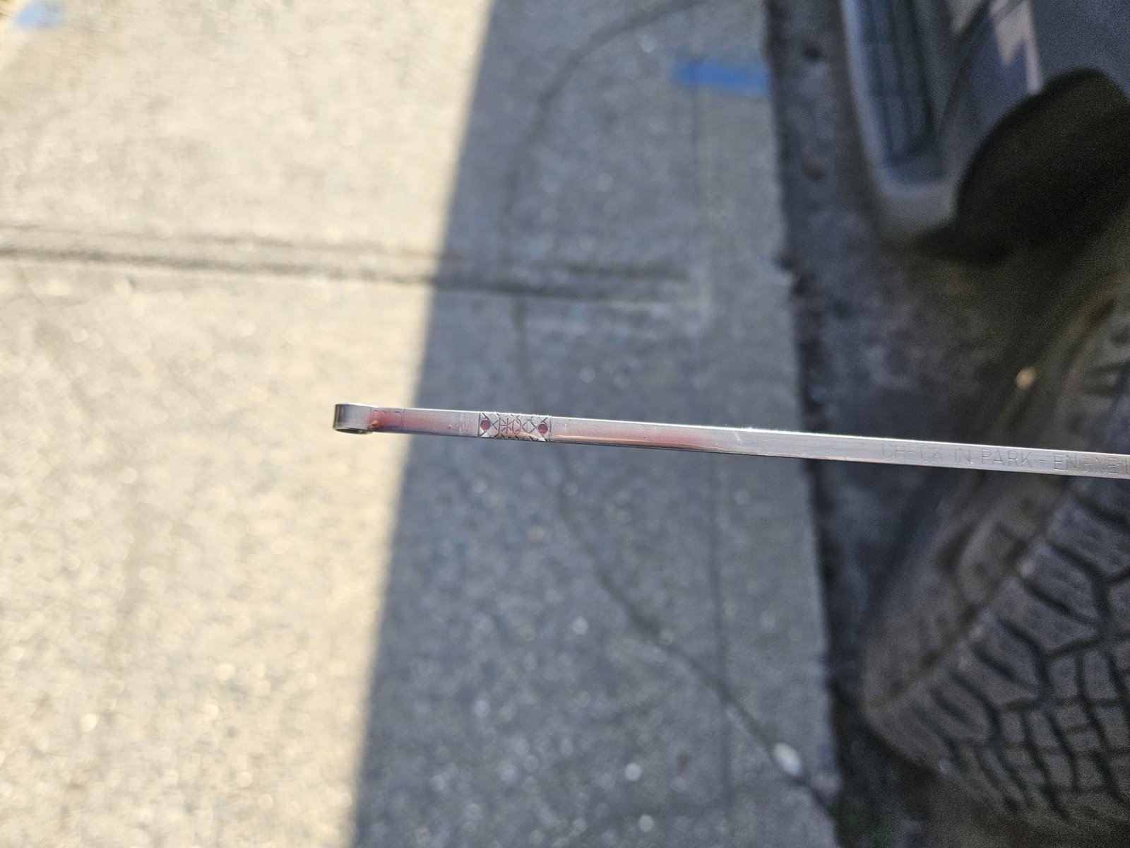

What are symptoms of a failing torque converter? Most times putting it in gear, it's fine--but sometimes if I stop then go, or turn around a corner, it'll feel like it's in neutral. Sometimes I have to put it all the way in park, then drive and it'll be OK. The other day it felt like it went into neutral, so I revved it, then I heard and felt a thunk--going into gear I guess, then it was fine. There's no rhyme or reason that it happens--just randomly. I think it happens mostly when it's still cold. No weird smells, fluid level is good. Fluid level isn't bright red/punk, but it's not burned either. Trans doesn't run hot either--I have the Esky trans cluster. Anyone have any idea? I was thinking of changing pan fluid then throwing some Lucas in it.20240312_161128.jpg
Shows a little over filled. Would that cause my issues?
A high fluid level is a....... concern......
But your description seems familiar..... Nearly like what I had in my 700r4.... A sticking valve, ..that I solved when I re-adjusted the Throttle Valve cable, that is attached to the throttle movement.
( The spring pressured valve, that is supposed to 'move' as per your acceleration, to adjust the pressure. ( Too low pressure, it can seem like a neutral..... Revving the engine, "moves" the valve and temporally "un-sticks" the valve.....
( Just a thought)
