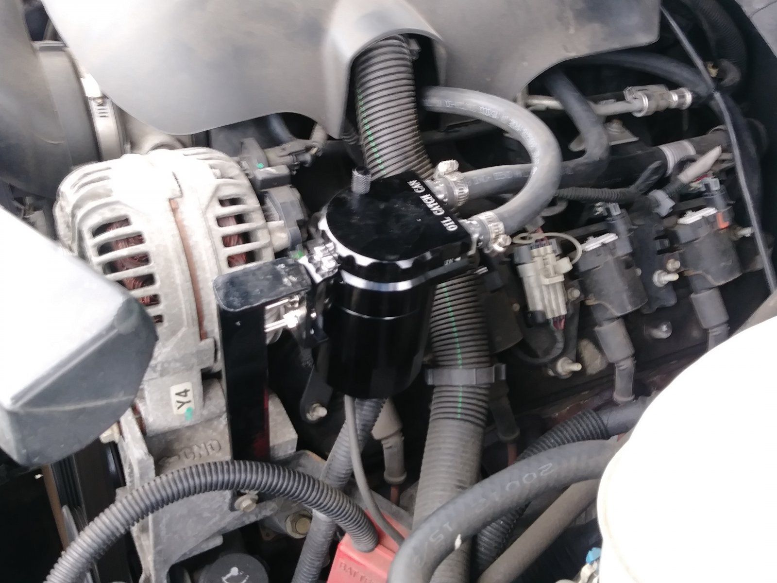

I installed a oil catch can a bit ago and now I have this noise like an air leak. If I pinch one of the tubes it stops so pretty sure its from the can but everything is tight and when you put my hand around trying to "plug" the leak and listen for a change I can't. So my question is does yalls do this also?

my can dont make any noise. if you hear it thats a vac leak. if large enough the engine will surge at idle. spray some brake cleaner at it and the hose ends. if you have flammable spray the engine rpm will go up, non flammable it will bog.

Yeah I can try that but the guy in the vid didnt have a leak and it makes noise. I kinda think it's like he found out it's just the noise of the air passing through the hose. That said I could be wrong so I'll check some more for a leak.

if you can hear the vacuum through the hose buy better hoses. i got that cheap ass can off amazon and the hose that comes with it is so thin, no way i was using it.

Yeah I replaced those hoses with some of this. I did some research and it is a common problem, some say it might be the length of the hose that makes the difference, I have a pretty long run. If it is just acoustics I may put a hose around the installed hose to quiet it.

your still using the pcv valve right? with out that regulating the flow you might hear it sucking the air through then.
