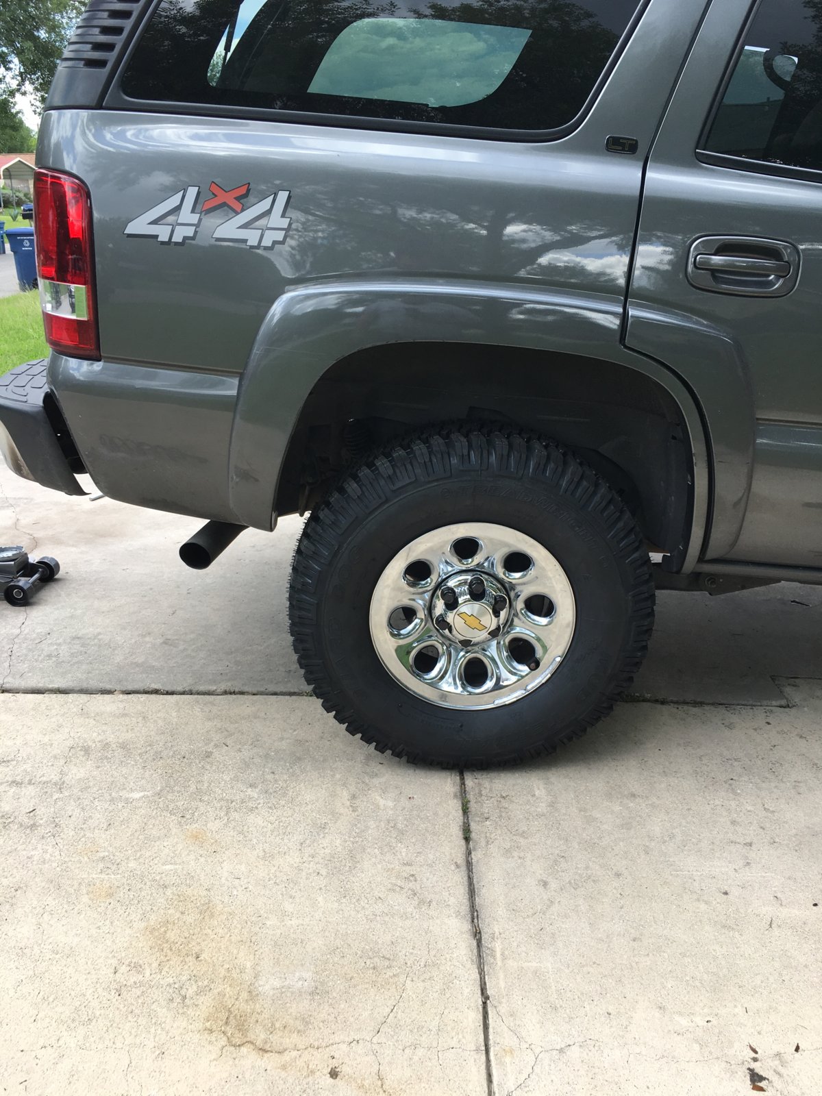

Wheels are on. ImageUploadedByTapatalk1432486737.900600.jpg anyone know where to find clear headlights? Hate those orange reflectors. Wanna retrofit projectors later but don't have the time or extra funds right now.

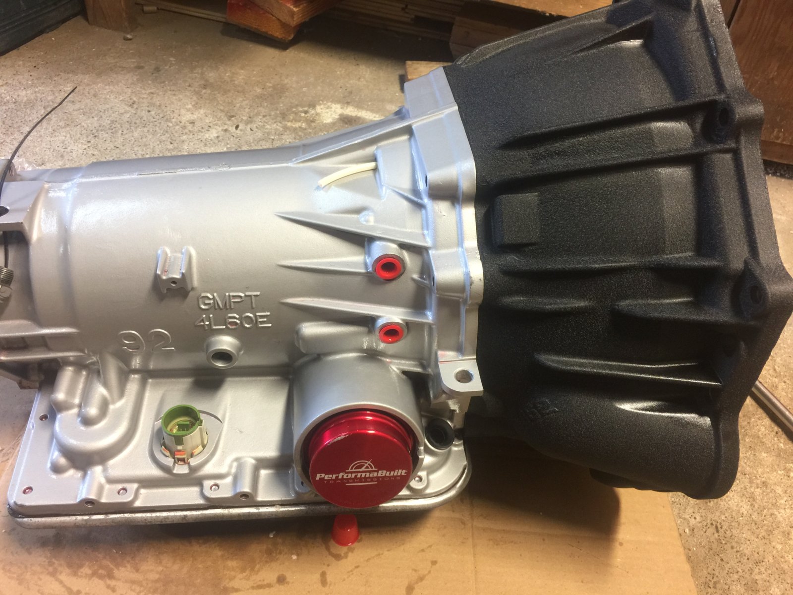

Corvette servo installed.
Couldn't get the pin out of the assembly, filed down the edge a bit and was able to slip it out.
Lost the eclip, bought one, installed the thing, found the original eclip.
Getting the spring clip installed that holds the cover in place was sort of a PITA.
Otherwise, it really was not difficult.

Did this make you feel more confident In your transmission? Did it make the shifts noticeably more solid?

I have only driven the vehicle up and down the street a few blocks. Shifts are noticeably more crisp and quick when driving more aggressively. At light throttle, shifts don't seem to be hugely effected, doubt my wife will even notice, but I can tell its there still.

Drove it to work today. It is a nice, noticeable improvement over stock. Certainly worth the time and minimal cost.
