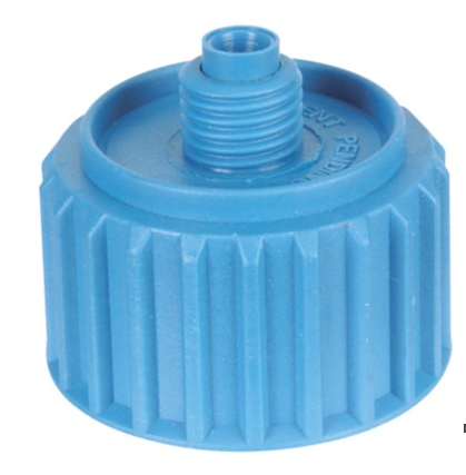

I still want you to! I'm sure it could be cut with a utility knife. Or a hack saw blade? I'm a bit behind the times, but I discovered and bought one of these not long ago:
I wish I would've had it when I was slicing that PVC pipe for my center caps.

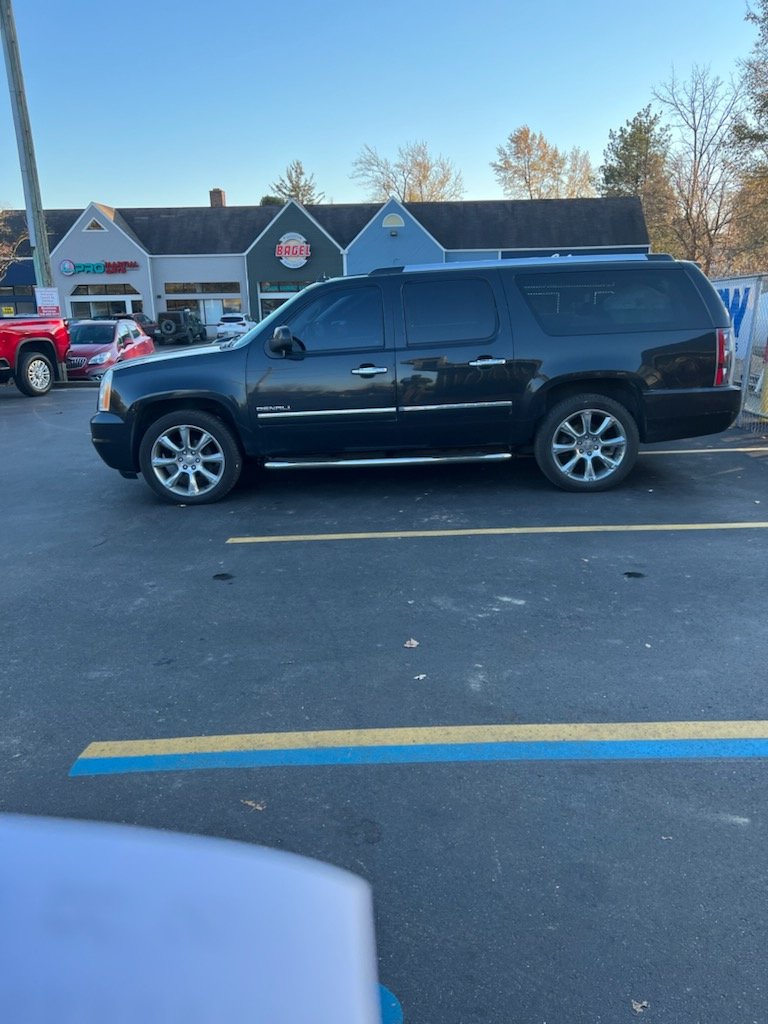

Finally, the rear Bilstein 5100s. Tried for Z71 springs but could not get to cram in there. Ran out of light, time and really it looked as though the springs were replaced. The PO towed a horse trailer: I would not be surprised if they are Z71 springs for towing purposes.
New rear sway links as an already in there job, too. Replaced w/ Moog.
Found a weatherpack connection disconnected. Rear, above exhuast and on top of frame rail on pass side. I plugged it back in..
Now I have an ABS and TCS light. I'll Chase them rabbits later. First I will clear codes to see if they reappear.
you might want to check the rear abs harness connection, the rear harness connects right where the top bolt for the shocks goes thru, there is a bulletin Arnott includes with there shocks to check to be sure you don't accidentally unplug them.
Yep!
When I swapped rear shocks on my ‘08, I read the bulletin, installed shocks, forgot bulletin, got error lights, remembered bulletin, fixed it.
