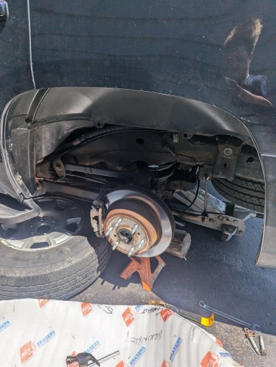

Gave her a wash. Solved my front suspension clunk, one of the upper control arm bolts was only torqued to 70-80ftlbs. I wouldn't have though that torque would let it clunk, but once I got it up to 130ftlbs the noise disappeared.
I haven't found my clunk yet. Going to have to take some time tomorrow and check a few things. I haven’t been able to duplicate it yet and it’s not consistent. Gonna check bolts and lube the sway bar.
