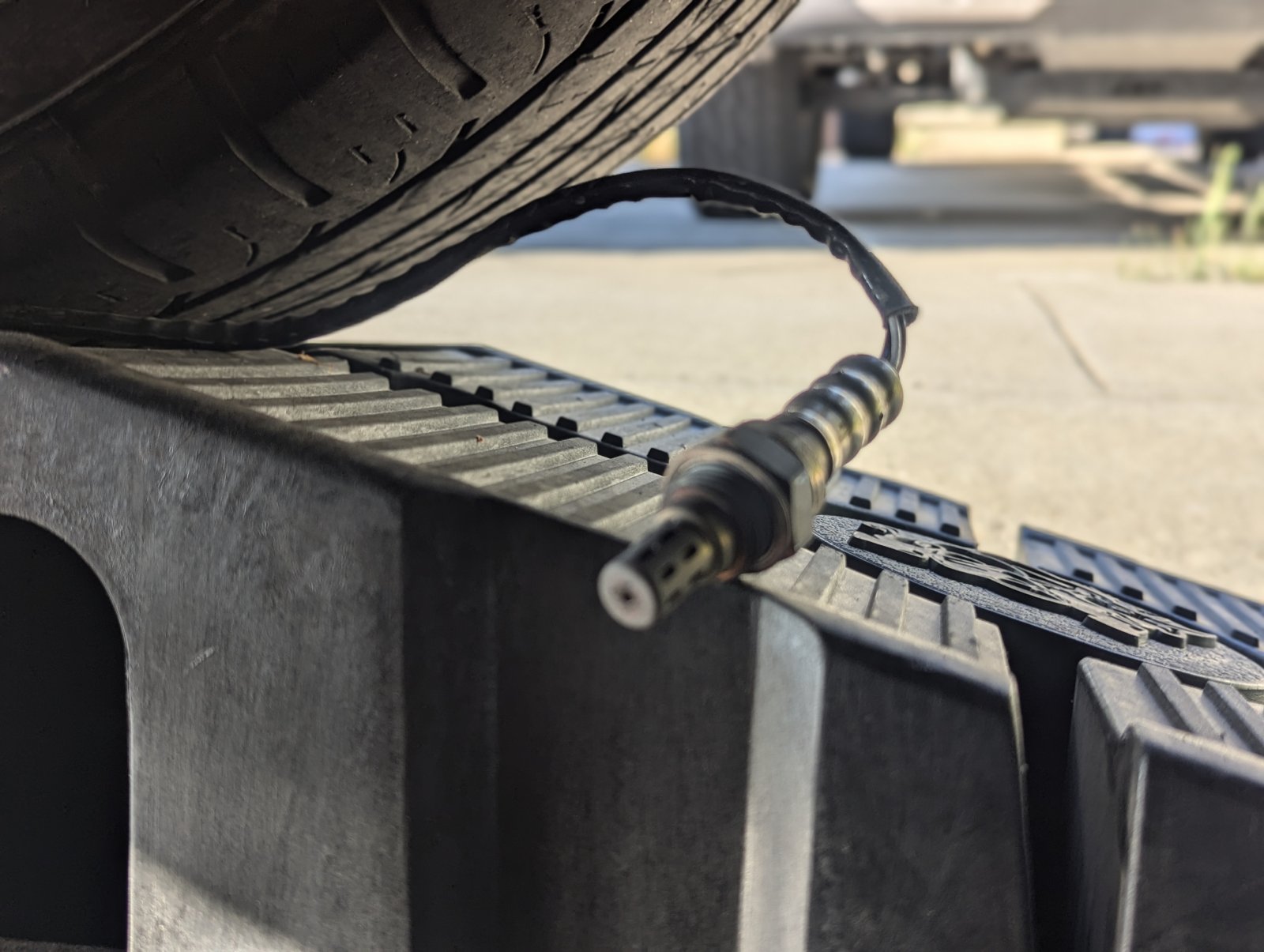

Trucks been running a bit rough the last few weeks. Changed plugs n wires in the beginning of the pandemic. Wife has been driving it recently. Got in it yesterday, check engine light P 0158. Changed out that o2 last year. What the heck..
