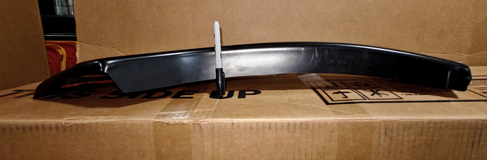

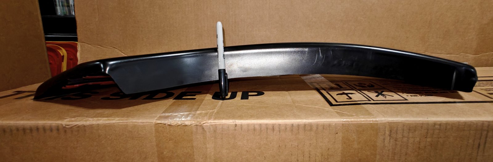

Trimmed off the clip's and the tabs of the bracket for front fascias lip. I think it look's better without it [emoji2373]. Also put my new headlights in. I need the fogs now.
Sent from my SM-N950U using Tapatalk
Read your post and did the same tonight. Thanks. I left the 2 sections where the brackets were as you can see. But much better looking.
