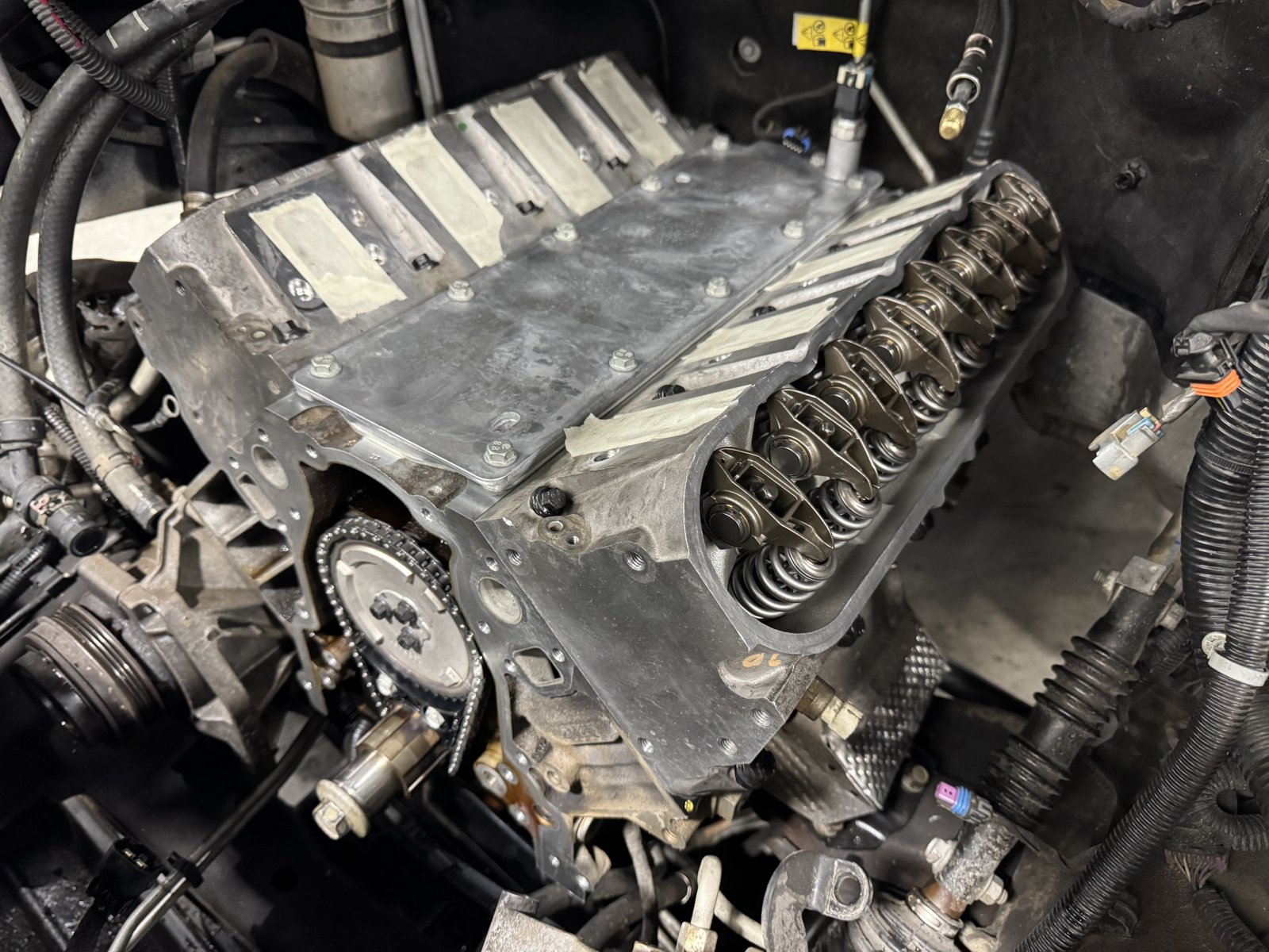

I'd leave it deactivated. My reasoning is that the lifters are held rigid by a pin that is retracted when AFM activates. If the pin never moves, the lifter can't collapse uncommanded unless a part physically breaks. If you turn on AFM, the pins may retract but not return to the "locked" position, leading to failure.
Sounds like sound logic to me.
No point in risking it from getting stuck... :D
I also picked up the deflector for the pressure release valve, and while i was there i bought a new pressure release valve.
I wouldn't doubt if the silly thing was stuck open or something.
I ordered a new pan gasket for good measure.
I'm sure i can use the one i bought on Friday, but it's worth the $50 to not take a chance of having to do it again.
Saving a good $15 between the cooler gasket and the pan gasket if i wait until Thursday.
