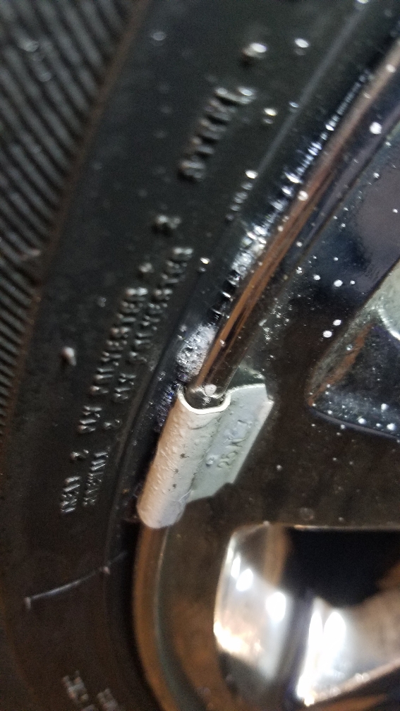

Put air in a tire. It was about 5 psi low and I had to put a couple psi in a couple days ago too.
Sprayed some soap solution around the stem and along the bead and found these bubbles. Looks like a small leak along the bead right where the wheel weight is attached

Annoying. Weight or corrosion?

Not sure, but I've never had a problem with it up till this past week. All looks OK. Guess I'll have to take it into a shop and have them check it out. The tire still has plenty of tread left.

On our 2007 with OEM chrome rims, had to take them in every so often and have them polish the bead seat and put sealant on it. Finally got tired of that and the flaking chrome and went with after market rims. Never had a problem with that after I switched.

Thats bead corrosion. Likely going to need to do have the bead polished up.
