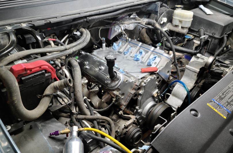

And while installing the valve covers yesterday.
I decided i might as well clean them up a bit.
No point to install dirty parts...
I thought for a moment about giving them a high polish, but went for a light brushed look using Fine grit 3M Crossbuffs...
Top picture you can see my AC flush tool that i used to prime the oil system... :D
I also replaced the oil fill tube, cap, oil level dipstick tube, and dipstick.
Went to remove the Oil Fill cap and noticed it's a one time use, lock tab breaks off! :D
And the dipstick would not remove for me when pulling the heads, it was a bit tweaked.
Found the local dealership had everything i needed in stock.
So i mangled the F out of the dipstick tube to get it out.
:greenchainsaw:
New one slid in after being well lubed. :cool:
:greenchainsaw:
