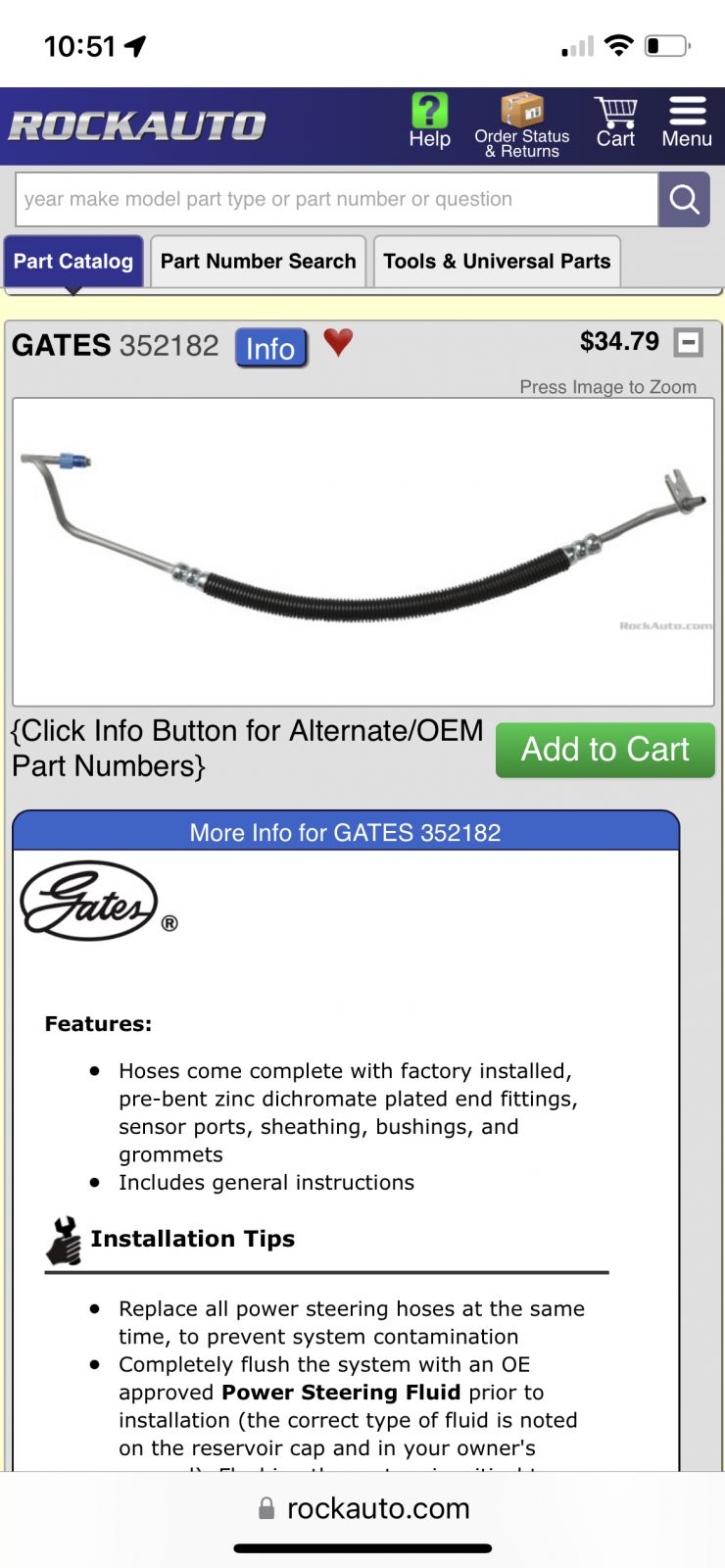

I need to replace that hose on mine. It's not leaking, but it's rusty as hell, especially behind the pump. Actually, it my be seeping a bit, because the metal tubing behind the pump is wet.
I'm guessing this is the correct hose?
No sir. This one. I saw the GM ones on rock auto as well, and both of them are erroneous or for another spot in the power steering system. The one in the image below is the one you want.
