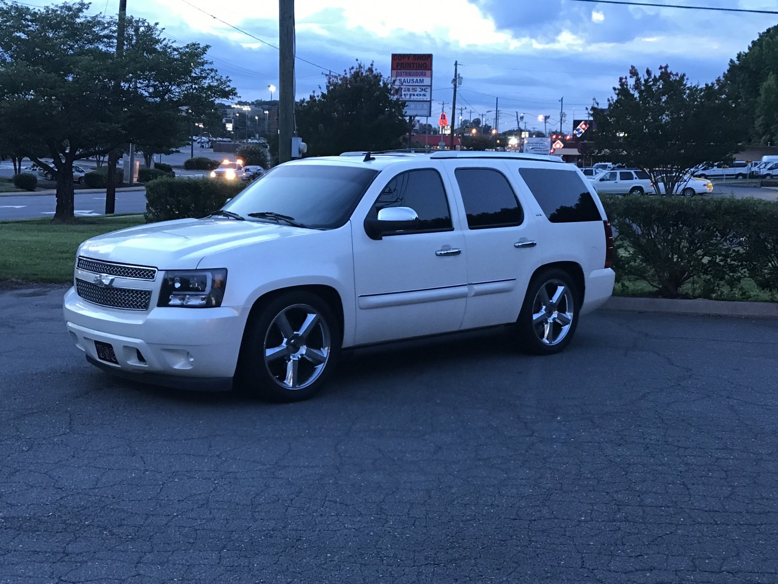

Looks real nice. Tahoes like yours make me think go lower and bigger wheels. I'm usually a lift it and bigger tire guy but torn of which way to go lol. Mine is bone stock and I'm itching to change that.
It is a 4x4 and I came real close to putting a level kit on it but that's not me lol
50,472
17,630
Mine 4x4 also. Low just looks too dang good :)
