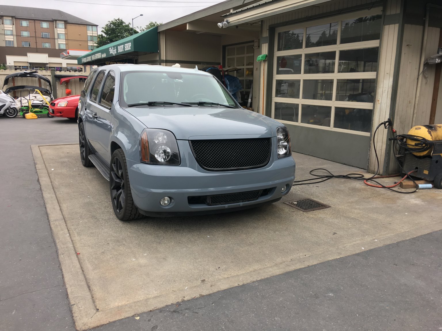

I appreciate all the input guys. I've got a buddy with a buffer and polisher that I'm going to borrow. I've done spot scratch removal with 3M products on this truck and my wife's old van. I'm partial to meguiars because I can buy it locally pretty easy and I've had good results to this point. I'm not looking for show quality. Truck is a daily driver and gets it's share of dirt and gravel roads. Again, greatly appreciate the help.
Here she is now.
