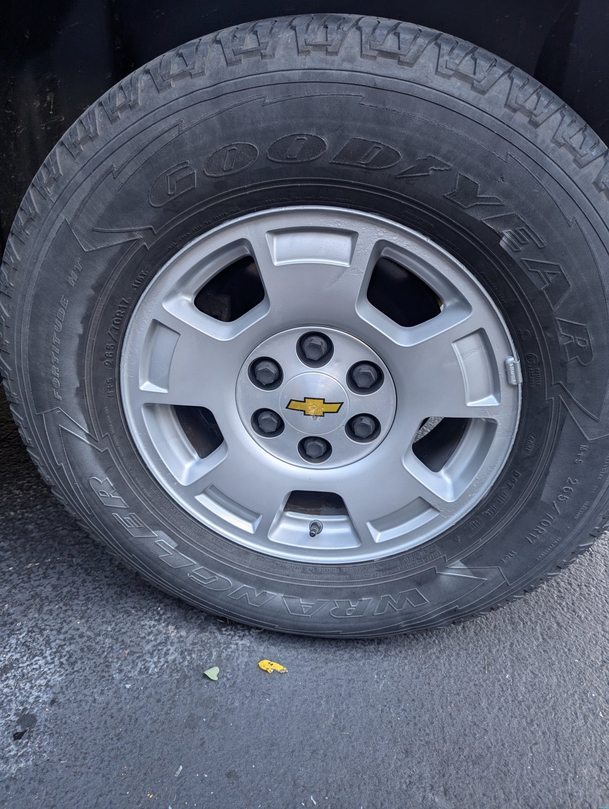

Wirewheeled and repainted these gnarly wheels (clearcoat had some off in chunks and oxidation was well underway) using Rustoleum Hammered Silver. Then I replaced 2 bad DRL bulbs with amber LEDs, the Fog bulbs with Amber projector bulbs and added the "Boost all lights" wiring mod. Very satisfied with the results on all accounts.
