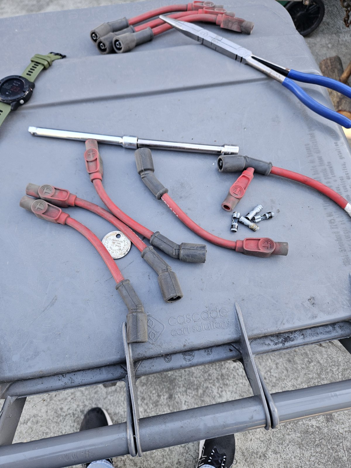

How can I prevent these wires from sticking to the plug? 5 out of the 8 ended up breaking. This set has been on since 2019 roughly about 60k miles
What's weird is that the crimped end was super easy to pull out of the plug once it ripped off the wire
It's one of the few things I hate on these rigs. I don't know the answer. I tried dielectric grease on the boots, they still rip off. I got special pliers, nothing works. I keep a set of spare wires on hand just because of this. I got a messed up #7 cylinder I got to check the plug on once in a while.
I have not ran any short wires or headers in years but when I did the fix was to use ceramic wires and/or a protective covering, fire resistant cover something like these
they worked quit well. they worked as designed.....
the heat is what causes the problem, that's why the oe wires have a heat shield

dielectric on the boots and keep the metal heat shields on and I've never pulled one out. I do have the special pliers too thou?
just twist them to break the seal and pull while wiggling. haven't broken one on an ls, I don't think ever. pulled some out of the old sbc cheap wires thou.
I run Magnecor on the ls3 car. guys complain about them pulling out, but had them off countless times without issue but that is with heat shield.

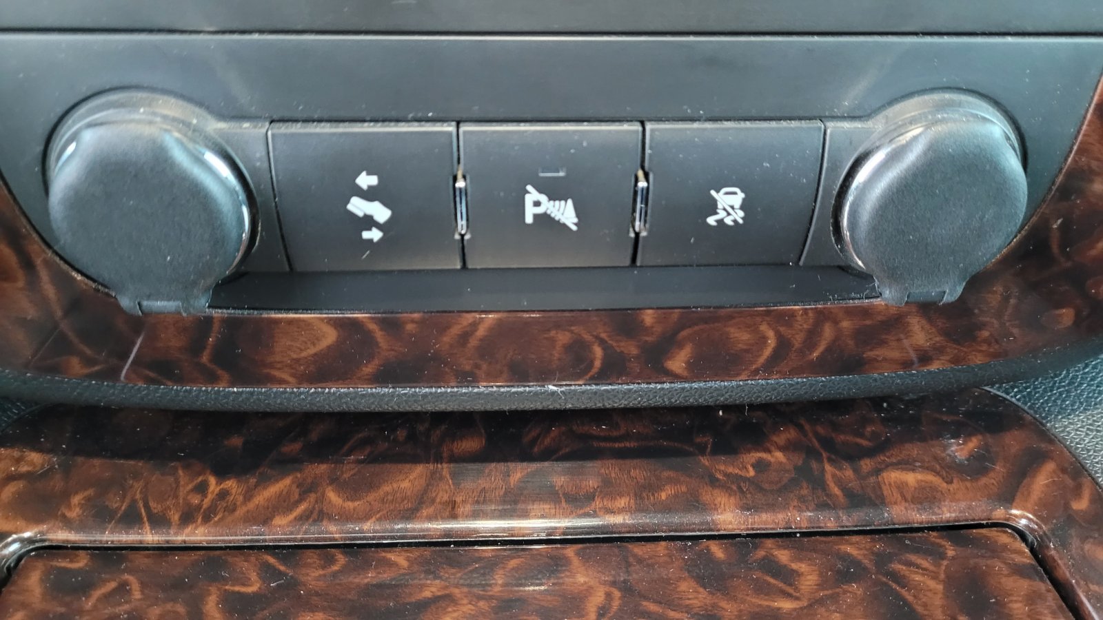

I replaced the 12v power outlet bezels and covers.
One was broken off completely and the other one was just barely hanging on for the last year.
RA had genuine GM pieces for like $3.67 each plus shipping.
I should have ordered some extras but I want to add USB outlets to at least one of the power outlets.
