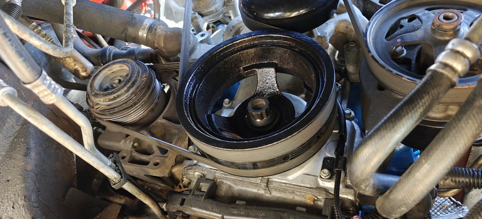

Forgot to add the finished pic after getting the better harmonic balancer screwed in, and the belts back on. You don't need the helper tool to get the A/C stretch-belt back on if you have strong fingers.
I was also troubleshooting why my driver's foglight was always flickering, and discovered the solder in the harness had broken, and the solastic goo that sealed the harness was the only thing holding them together.
I scraped the goo out of the harness adapter, resoldered the connections, and filled/potted the harness with room temperature vulcanization cream. Seems to be working fine now. Back to having two yellow foglights.
