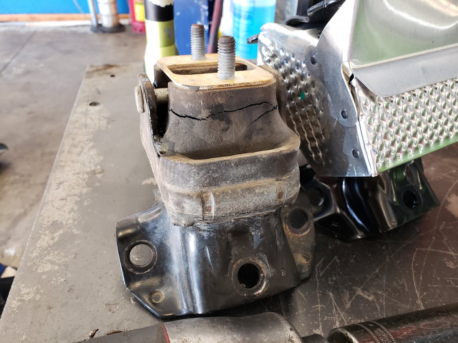

I replaced both heater hose tee's. since one decided to break off just as the wife pulled into work. Good time to replace the hoses and thermostat as well.
