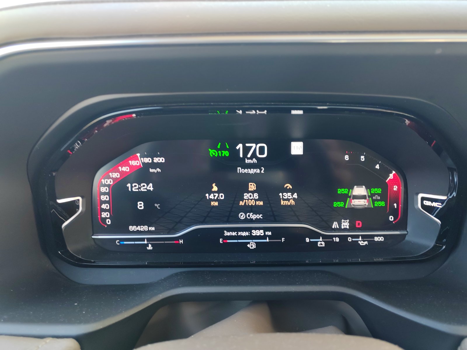

It is clear that I drive completely differently than the average American)) Fortunately, our toll roads in Russia allow us to move between cities quickly and comfortably.
The photo shows the revs at a speed of 170 km/h, which is about 105 miles per hour
But you just said above that it is fast driving under load and in the heat that kills the 0-20 oil. Well, it doesn't kill anything. The oil works fine. I repeat, I have 75k miles, and I change the oil every 7500 miles, without resorting to early oil changes. The only thing is that I change the fluid in the automatic transmission and transfer case and axles every 30K miles.
Yes, and I fill up with petrol grade 95 in Russia, which is about 91 according to the American standard. So there is nothing unusual, I just follow the regulations prescribed by the manufacturer.
