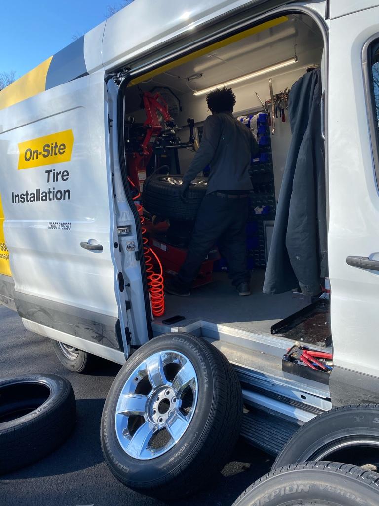

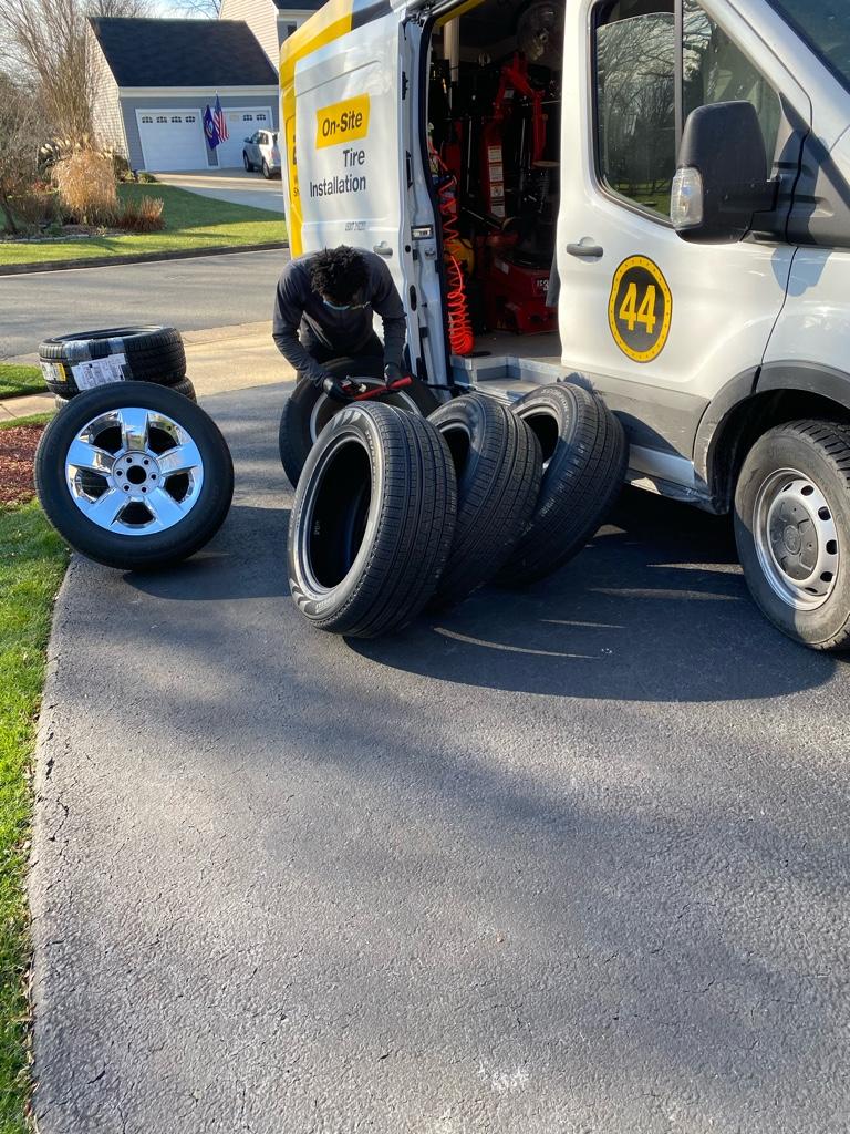

Just had mine done with the mobile tire service from tirerack. Came right to the house. I watched him do all my tires and when he balanced them the computer noted where to place the weight on the inside of the rim with a laser dot. Some were closer to the inside and some near the front where visible. Doesn’t matter to me as long as they are properly balanced.
