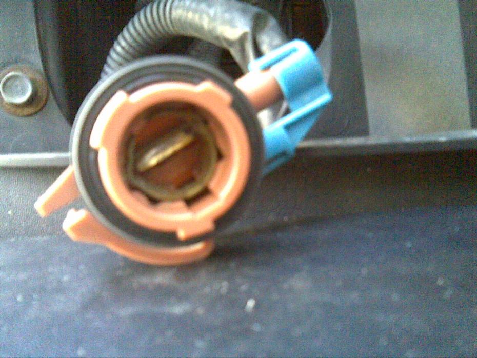

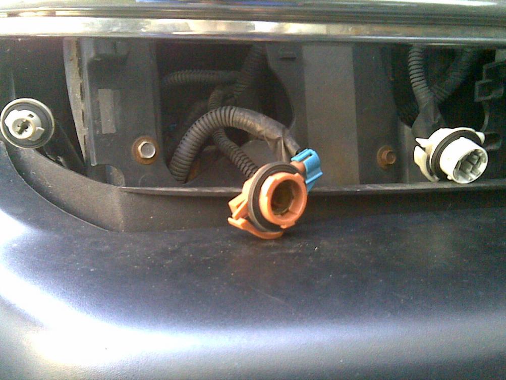

Just trying to figure this out, because i bought the LED bumper lights, and they are really nice, but the white part of the light never comes on, it seems that the orange part (for signal) is on all the time, and then just flashes brighter when i signal... but i thought the white part should be the one on full time and the orange just comes on for the signals... i am lost here...
but i am just trying to figure out how it works when it's stock, then i can try to figure out my LED thing later.

i can tell that it's not on when i am driving (can see the refelction in the vehicle infront of me) only the orange turn signals are on.. which as i said, flash brighter when i signal.
i'll have to check for a blown fuse or something, the ends for the white lights looked a little cooked, just need the weather to cooperaste for a day or 2..
are your orange lights on all the time too?
