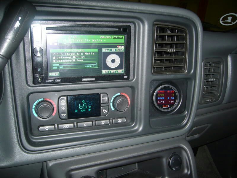

How many gauges u plan to use? I thought about the steering column mount but decided against it.. How about about a dash mounted gauge? This a photo I found online..haven't mounted mine yet since I got some other work in progress, but this was a cleaner look to me.. c0af83ac846b542ad5b4d65814221c49.jpg my shallow AEM gauge fits like I wanted..

I'm just going with the one gauge since it takes care of both things I want to monitor. I already use that space for my cell phone mount though. Also, I want the gauge up close to my line of sight while driving. I'd rather not have to look way down there to check boost or AFR while smashing my throttle! I ordered the Autometer. The gauge will be right up on the a-pillar where I won't hardly have to move my eyes.
