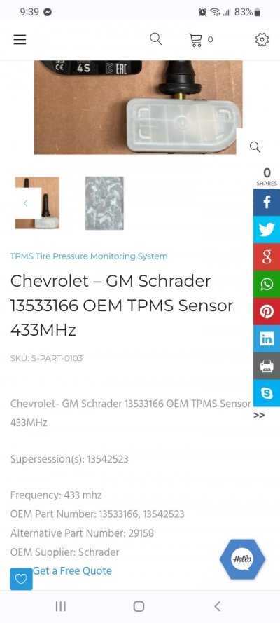

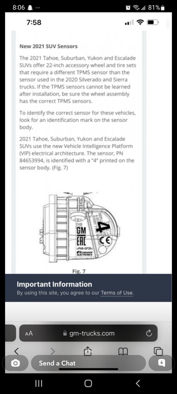

Update on the TPMS. Like mentioned earlier I bought a set of TPMS from a 2022 Chev Silverado to put in the 2022 Yukon. Both are 433mhz. They are not compatible with the Yukon. Yukon's use a VIP self learning feature from what I gather and will not pair. I have now been able to secure some OEM ones brought in from another dealer as they are still on national back order. That being said the tires are all built and ill have to pay again to have the tires and rims tore down replace sensors and put back together.

This post has me a little concerned as I have summer tires/wheels that have the GM TPMS sensors. After reading your post I went to the GMC and the Chevy site to look for the TPMS part numbers and the are identical. I checked for a 2023 GMC Yukon as well as a 2023 Chevy Tahoe HC and they list the same part number, there was no mention of a VIP self learning. The 2022 part numbers for the TPMS sensors are same, below are the correct part numbers,
GM Part # 13542523
ACDelco Part # 13542523
GM Part # 13542523
Those are the P/N I bought.
They work awesome!
