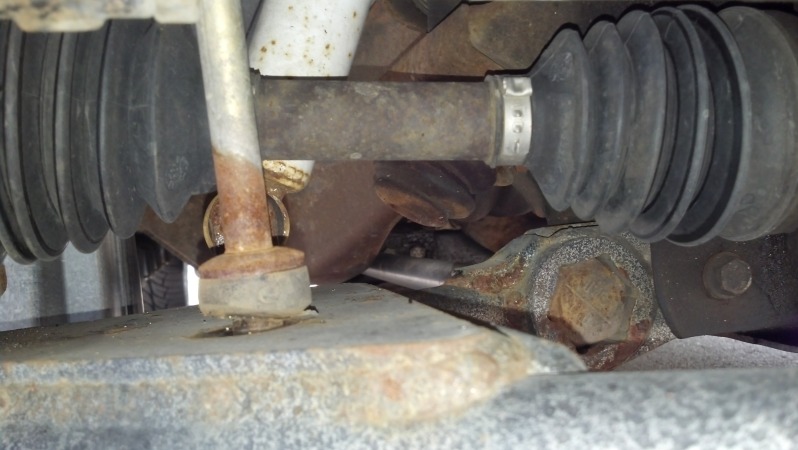

idk i just had always heard that it was a bad idea lol..im on djm arms and stock keys..what is the part number for the shocks? i know that these are crap..
here is how far my bolts are out
like 1.5" to the arm from bumpstop while on the ground..
and droop
