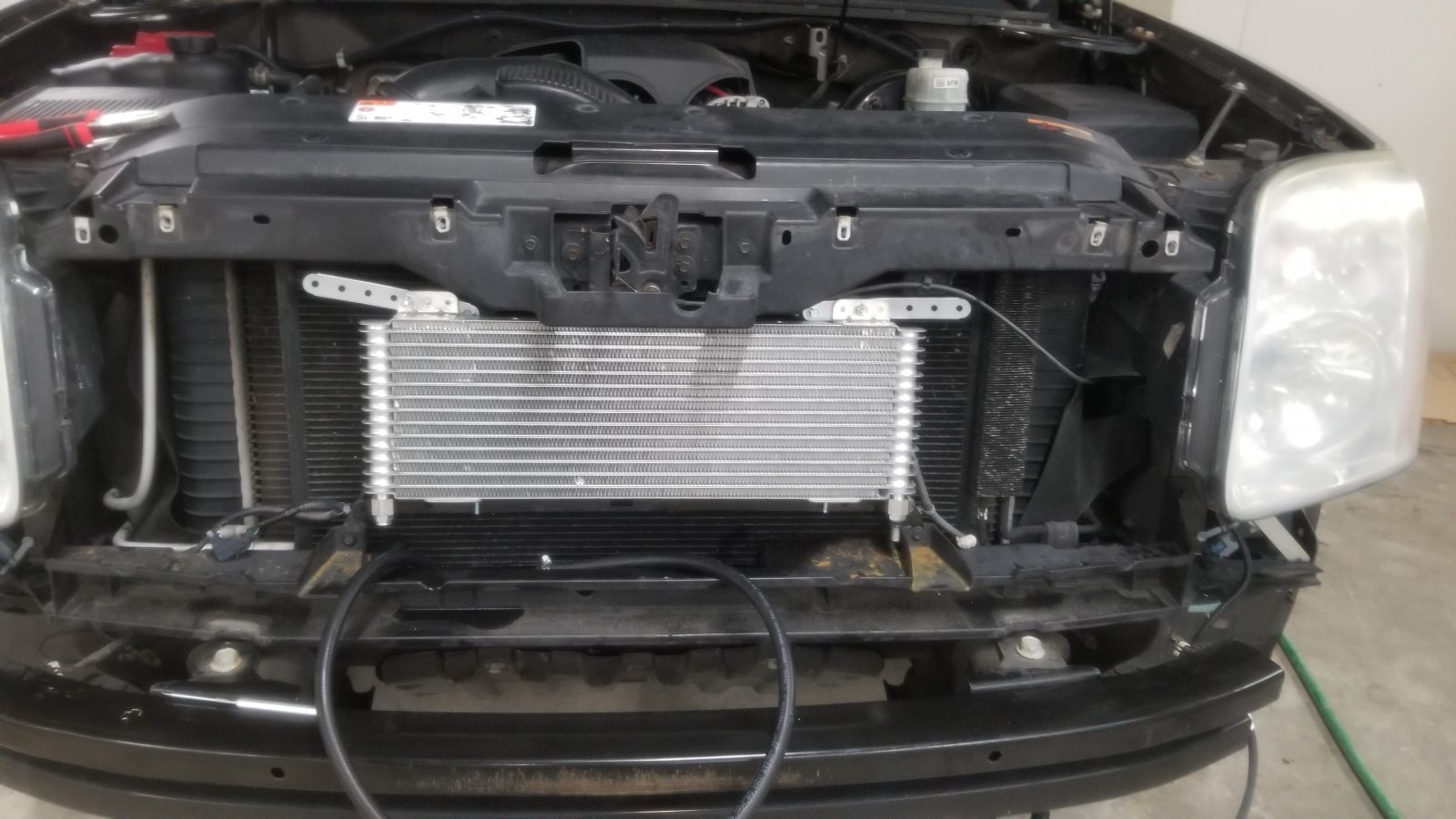

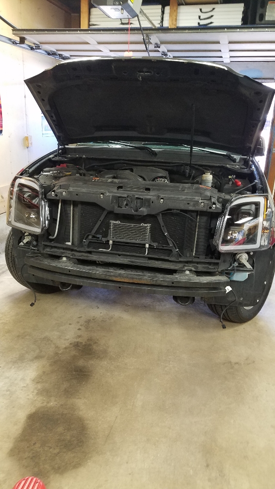

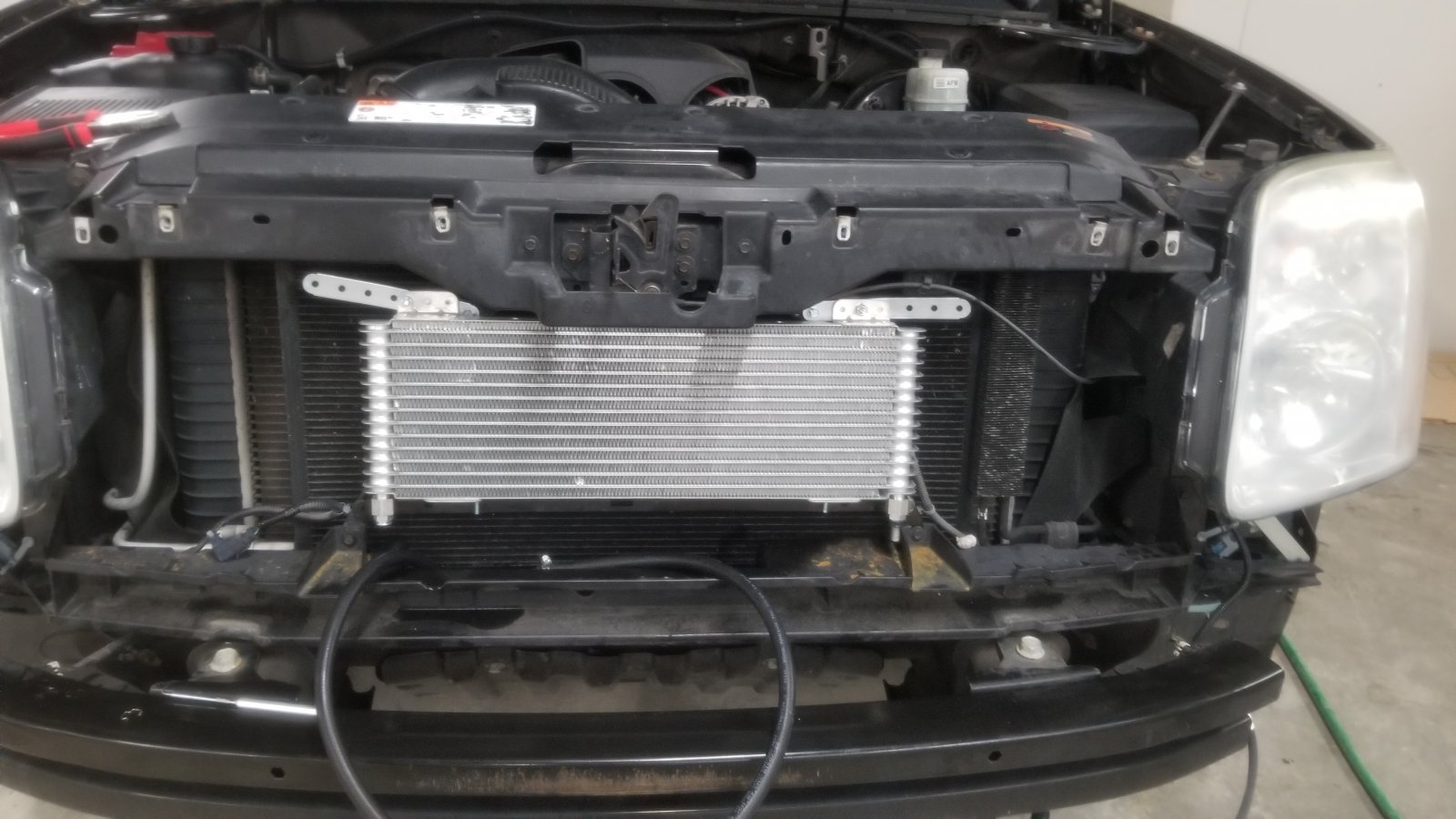

Something I didn't see in this thread is to upgrade to an external transmission cooler if your Yukon doesn't have one. The engine is a workhorse and will handle 4000 RPM all day long but generally when towing the transmission will run at a lower numbered gear which will drive up the transmission temperature, especially on hills. You want to keep the transmission temperature around 200F.
A weight distribution hitch is a must.
