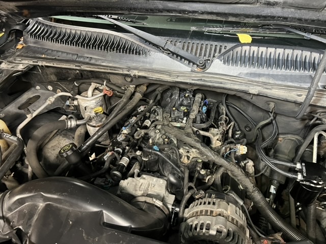

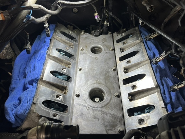

Finally got it back together. Who do these people think they are, wanting me to do work things while on the clock. I have my own stuff to do!
Pump and hoses on.
I couldn’t bring myself to putting fan shroud and engine covers on with how dirty they were. So I washed them in the parts cleaner and then bucket washed with warm water and simple green. Then rinsed with clean water and let dry. I even removed the insulation from he backside of the covers so they wouldn’t get wet.
Then I wiped everything down with Armorall before installing.

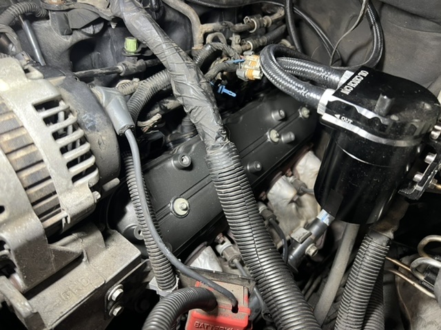

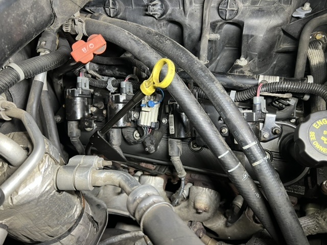

Parts came in a day early so I was happy to get my ac working again.
I almost forgot to get a picture of tensioner installed.
Belt fit good. Could tell the old belt had some stretch to it. This one was noticeably tighter. I wasn’t sure that I had the 130A alternator but the old belt number referenced a 93.1” belt and that’s what this new one is, didn’t say it’s length, just 130A alt. Had to break down the numbers before ordering.
Next thing I need to do is an oil change and have the EGR “fall off”.
