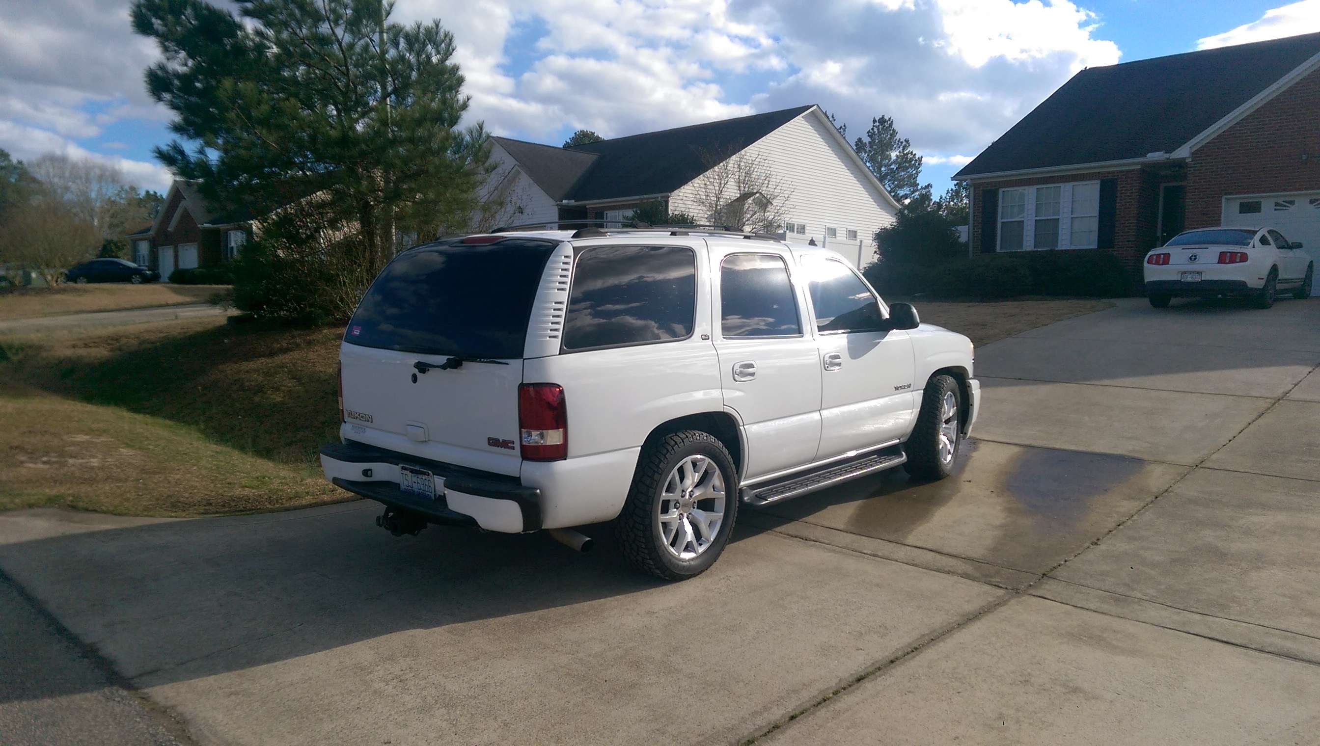

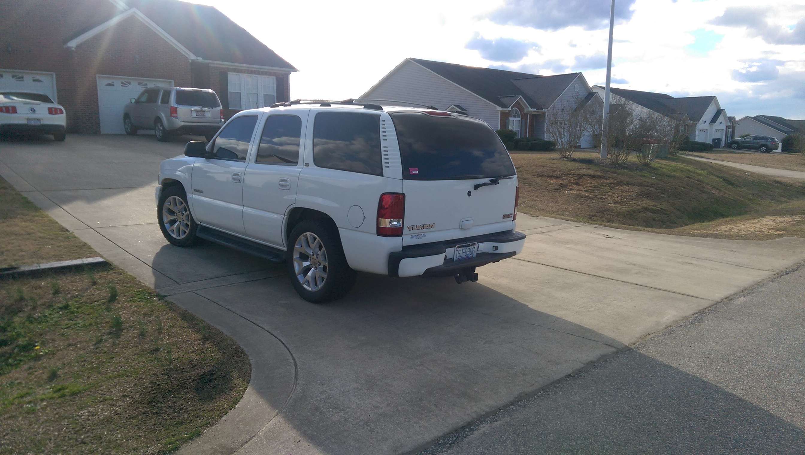

Quite a bit of updates, but not many pictures over the past few weeks. Finally got the spindles and rear springs installed. As you will see in the pictures, the 2/3 drop seemed too low in the rear for me (especially with the A/T tires). I ended up ordering a 2" spacer to replace the 1" one that came with the kit from Tony. He was a big help, especially since the shop incorrectly installed the rear end links >.< It rode like a radio flyer wagon until I had time to drop it back off and explain the issue.
First set of pictures are with the 2/3 drop...which was too low for me.
Now here are a few pics with the 2" spacer to raise the rear up a bit.

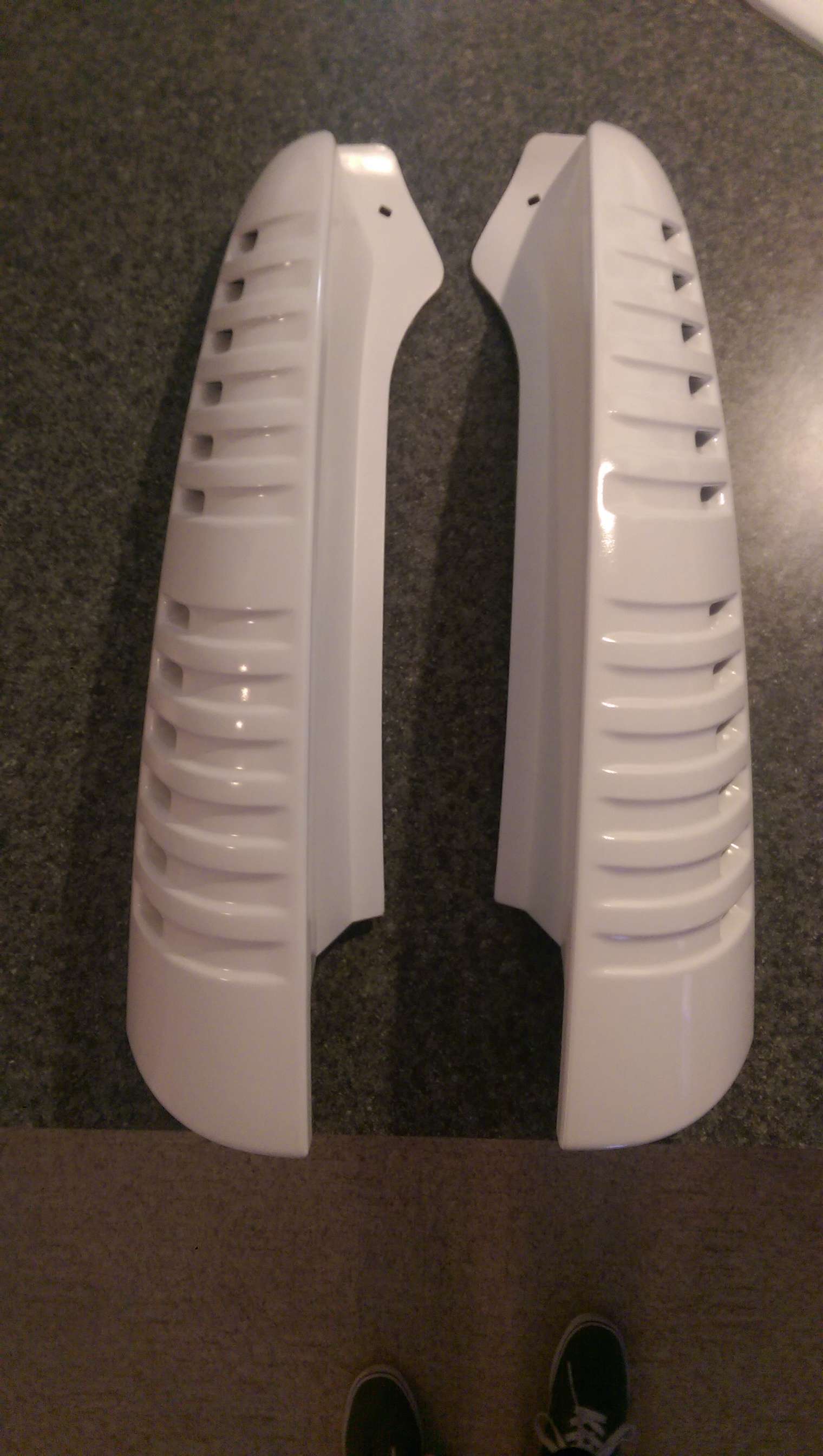

I know it needs a good cleaning, but the weather has been sporadic lately. And to add a slight teaser pic, I'm not worried about the paint because I'll soon have the sides and rear painted when these new pieces are installed :cool:

How did it sit that low at 3 inches? What kind of shocks you have in the rear? Did you measure to see where the fenders sat at on the 3 inch drop?
Right rear was 34" exactly and left rear measured 33 and 3/4 with the 1" spacer. Both fronts measured in at 33 3/8 with the 2" spindles. I don't have a measurement right now with the 2" spacer, but I can check on that in the morning.
