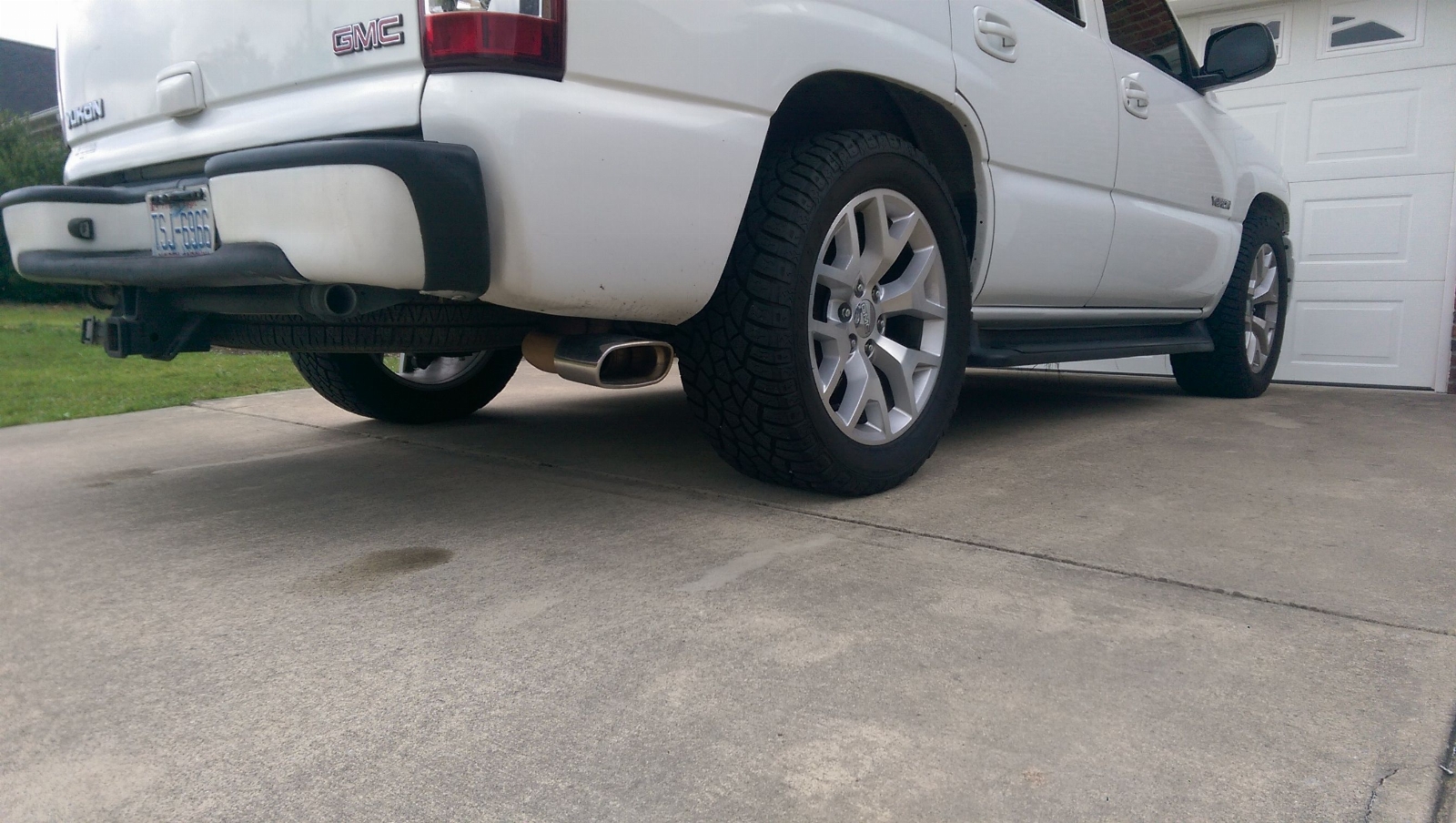

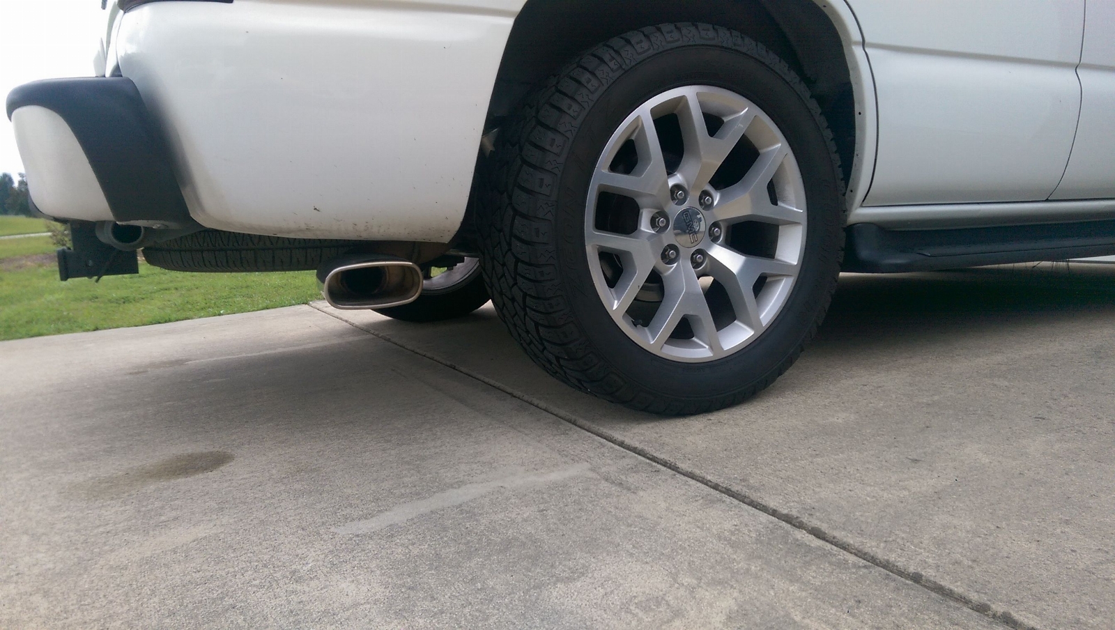

What kind of shocks are you running? You should be around 34 1/2 with the 1 inch spacer. That's where I will be once I get my Belltech shocks put on. I'm running 275-55-20 tires.Right rear was 34" exactly and left rear measured 33 and 3/4 with the 1" spacer. Both fronts measured in at 33 3/8 with the 2" spindles. I don't have a measurement right now with the 2" spacer, but I can check on that in the morning.
