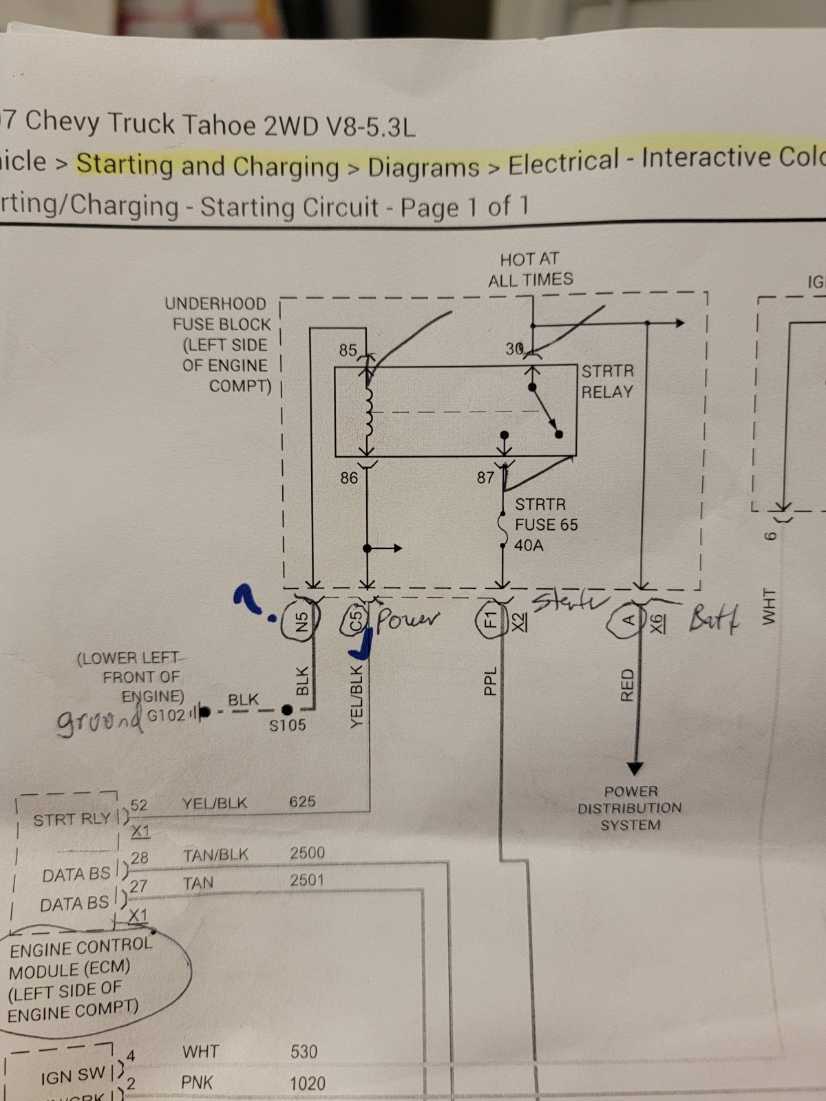

Im not quite sure what you jumpered in the ignition relay whether it be the control side or the controlled side. Im assuming you jumped the 2 contacts for the controlled side which is what feeds the 12v to the starter solenoid to initiate starter spinning over among other things that happen during that evolution. If not, correct me.
Now as far as the control side of the ignition relay, remember there are 3 things that you need here. (1) Good relay (its coil and contacts) (2) 12v going to the ign relay coil. (3) Ground to that same ignition relay coil. (just had this problem last week from another poster in 2000-2006 section where he was missing ground for the relay).
So here are the schematics involved and the chain of events that happen. (Little bit different from the 2000-2006 chassis).
And the first thing I would check is the main power trigger (Notice I did not say feed) for the control side of the ignition coil which is Fuse 34 2A marked as DLIS. This has to pass through your ignition SWITCH to Plug C1 Terminal 21 of your BCM. The BCM outputs 12v on Plug C4 Terminal 21 directly to the ignition coil relay which if it has a proper ground will energize the internal contacts to close and the starter will begin spinning over and the ignition system and fuel system will all be powered up along with the proper parts of the PCM.
So I would check the Fuse 34 2A DLIS first then if its ok, pull the ignition relay and check the socket for ground for the coil and then have some hold key forward to engine crank position and check the ignition relay socket for 12v at the coil positive terminal.
Let me know what you find or dont find.

The Constant on 12v is the feed to the starter motor solenoid. This is part of the controlled part of the relay (Normally open Contacts). It seems your problem is in the control side of the relay (Coil). Not sure what that 8v is about but you have 12v when the key is put to the crank position which is what we are looking for. So assuming coil in relay is good, you have a bad ground to the relay coil or broken wire between that relay socket and chassis ground.
Terminal 86 is your coil 12v (Sounds like you got that when key in crank)
Terminal 85 is your coil ground
socket may be marked, your relay should have a mini schematic for terminals or the bottom near the stabs should be marked.
I am assuming you have had relay installed and had someone put key to crank and did NOT feel the relay slam shut.(click)
