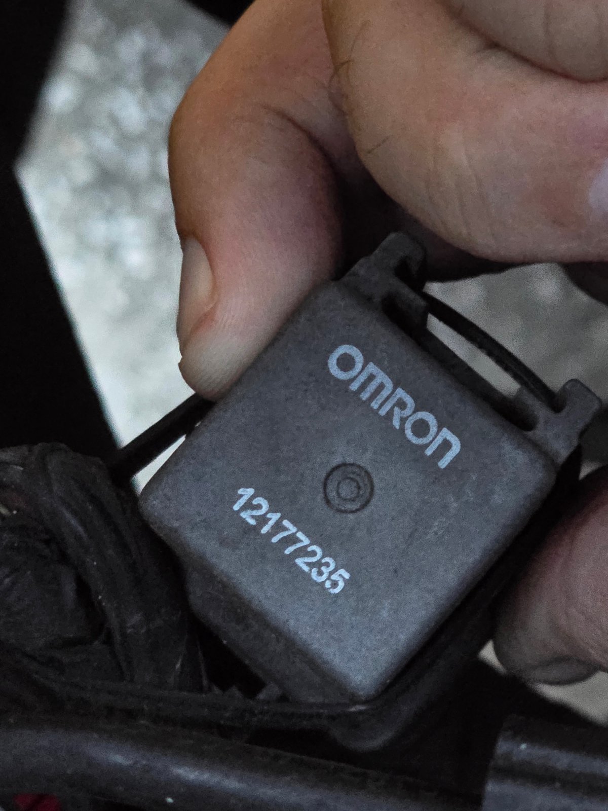

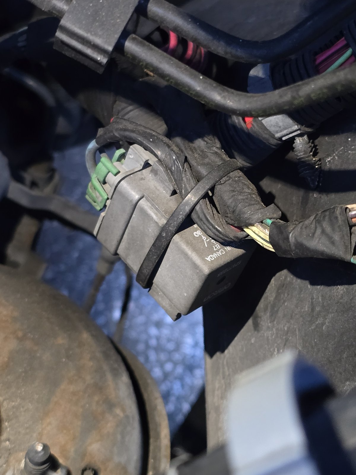

did your air compressor come with a new relay? if not the relay is strapped/or taped to the main wireharness in the engine compartment typically right below the brake fluid resevoir area, kinda can't miss it, big relay. the compressor should come on anytime it is commanded with the tech 2

new compressor didn't come with a relay I don't believe. I will double check when I get a chance (its pouring right now and I'm on my phone at work)
I bench tested both the old and new one. new one comes on with 12v power, old one does not
