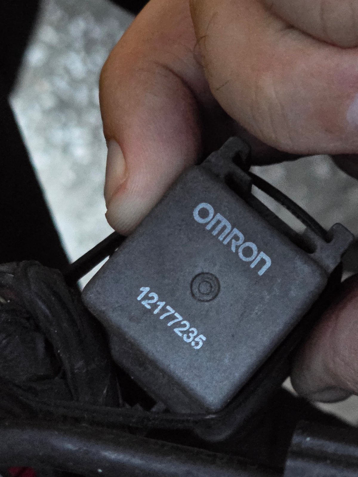

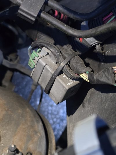

Is it this one? Seems like it. Also see a completed unconnected wire by the same harness. Pics attached. If thats the correct relay autozone has it for $20. Part # 19265 .
the red wire is for either trailer hitch power or trailer brake controller power (i don't recal which) but it is one of those, the other red wire is on the side of the fuse box nearest the fender.
and yes that is the relay for the pump, so part of the problem solved.
