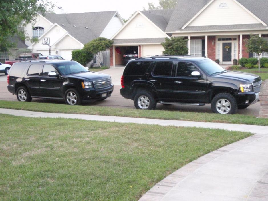

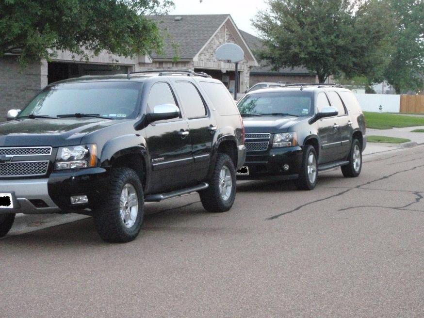

the finished product!
if anyone has questions just ask because i basically took pictures throughout the entire process

i have only had them up to about 45 mph and they were very quiet
they ride excellent...i thought they would be very rough due to the increase in tire air pressure but not at all
