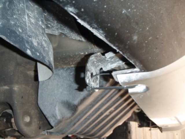

Emann, question. Do you think the Duratrac's will fit with a CCM leveling kit? I bought that to install and just noticed your's was the Truxxx. CCM is a 2.5/1" rear, not 1.5.
you shouldnt have a problem fitting these tires with the CCM kit...the rear has plenty of clearance....remember that you will more than likely have to do the same trimming that I did up front

Well, couldn't fit the Duratracs on mine with the CCM 2.5/1". Not sure why, but I would have had to do some major trimming to allow for wheel travel. It wasn't just rubbing behind the small black piece on the bottom of the bumper, it was rubbing a good 3" above that. Any travel up and down would have made it worse. Not sure if there is a difference between the 08 & 09 that made the difference. I did notice the small black piece on mine looks different than your 08's.
Ended up putting on a set of 285 BFG's. Will post some pics later.
