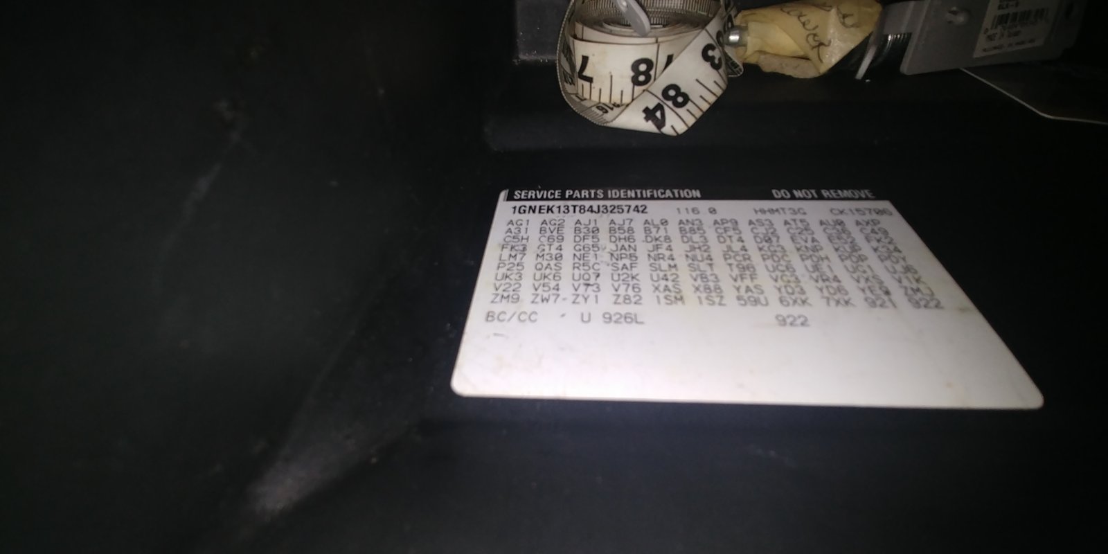

thanks. anyone know how i can find out what type of transfer case is under there exactly?
