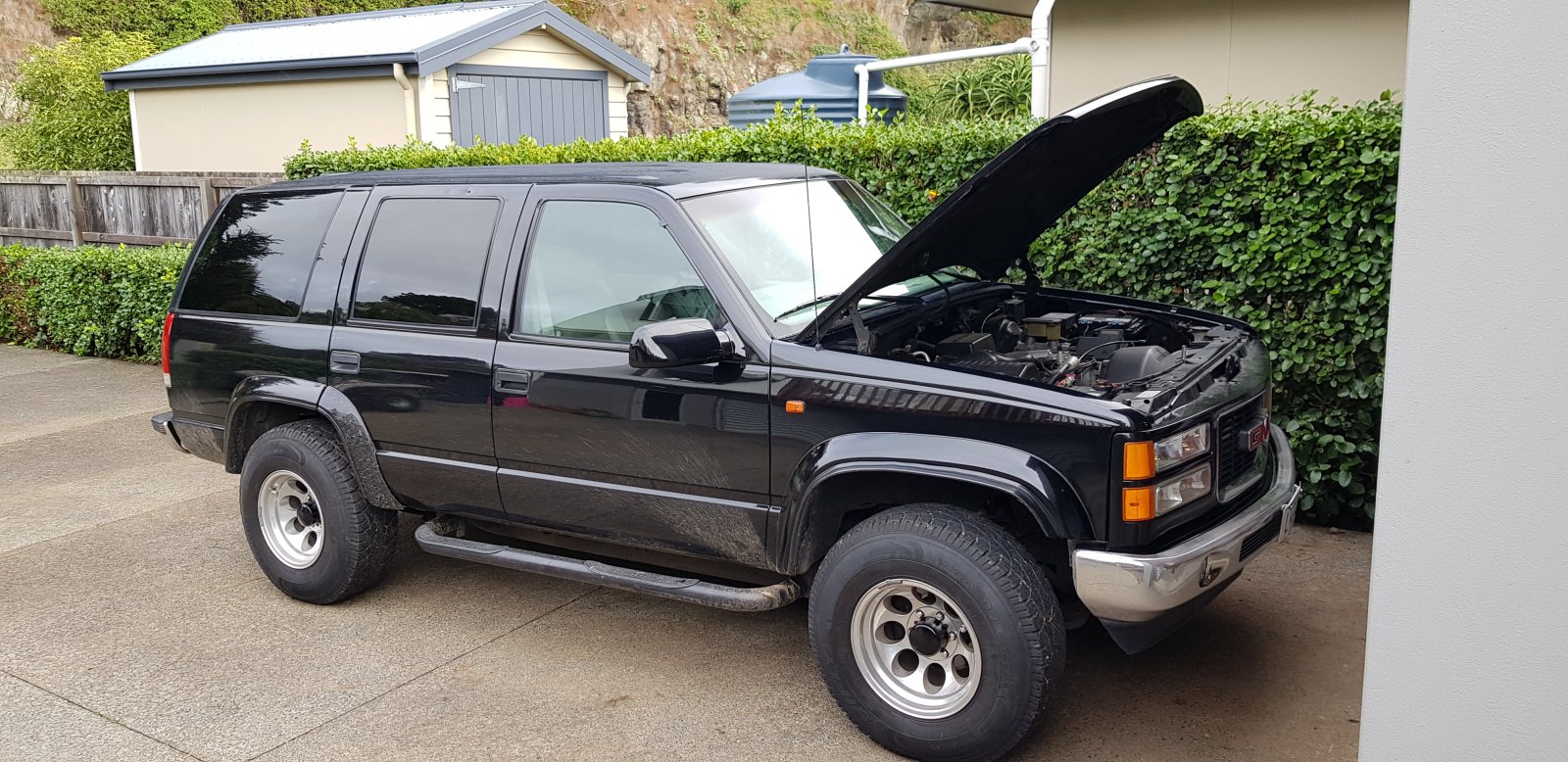

Alrighty!! Solved the couple of issues with the great work the mechanic did. [emoji122][emoji122][emoji122][emoji122]
Ended up being about 6 things I had to change or connect. Got a bit grumpy and broke the purge line into 3 trying to get it back under the aircon housing as it was put back as an afterthought during reassembly. Brittle this old stuff ay!
Gauges working again. Lol petrol one is working and yes I need gas! [emoji6]
While I was in the mood I thought I'd do a feel good job and install the 2" lowering shackles. Easiest job I've done yet!!
Will go for a drive and see how it settles.
Think it is just about bang on level! [emoji2937][emoji41]a8f2926336db8794ec441d952dcdd83e.jpg2234d795afc8e3403276eca16a6ae540.jpg
