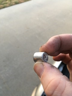

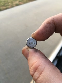

Got thermostat changed. Heres a pic of them the new ACDelco one is on the bottom and the motorad one that was in the truck is on the top.
Anyhow...put it all back together, filled the coolant back up, and test drove it.
While it was not as cold today, only 27F instead of 0F lol, Im pretty sure I have a big difference. I have lukewarm to mild heat right before the temp gauge even starts moving past 160F.
Before with the old stat i had practically no heat even when the temp gauge started moving.
We will see. Ill let it cool completely down and see how it does on a really cold day.
