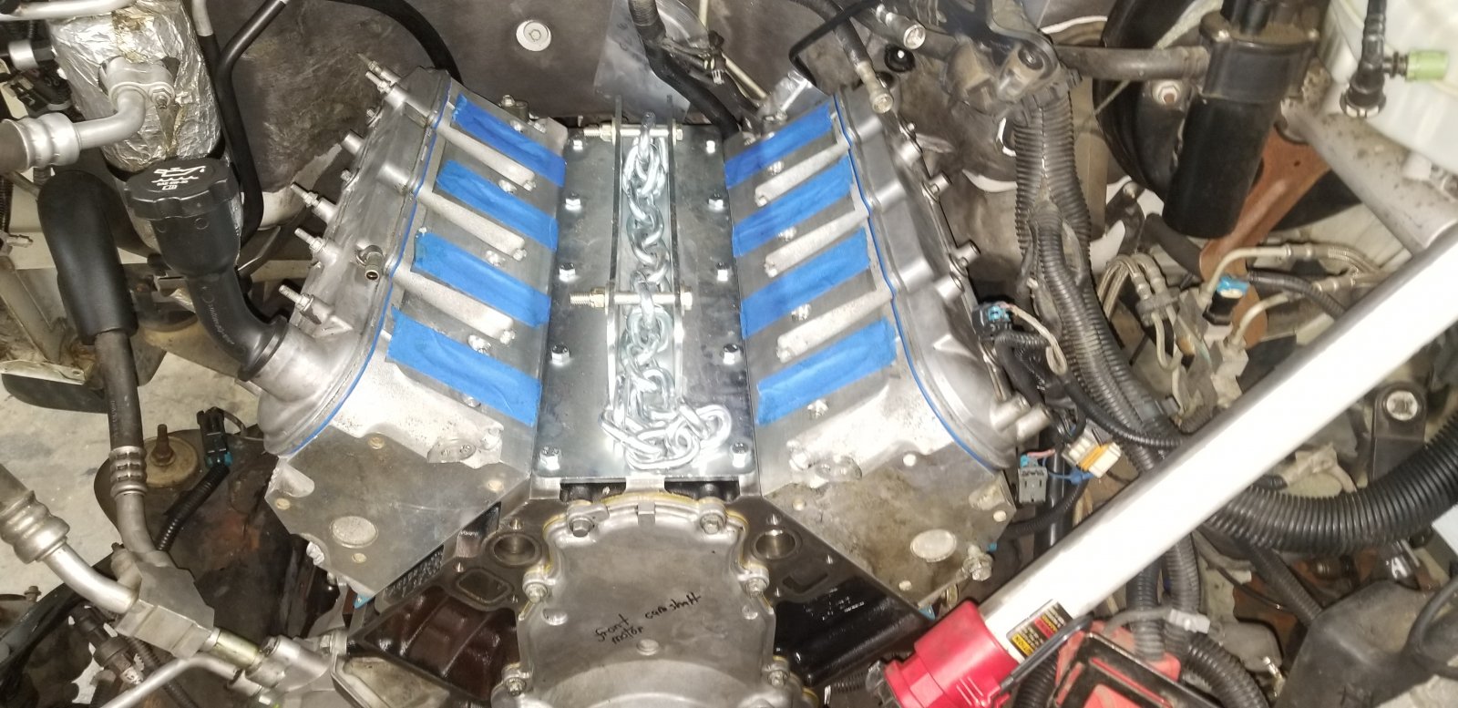

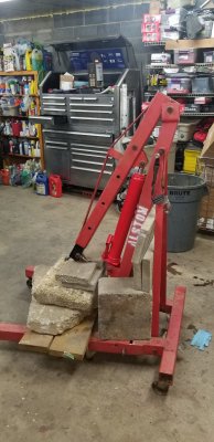

I got it primed this evening. I also got the motor lined up with the transmission dowel pins. Took me by myself two hours. Wife lowered lift a little so I could line up the motor mounts/bolts both sides.
I am happy with the little time I could work on it today.20191129_195659.jpg 20191129_195707.jpg 20191129_195640.jpg 20191129_195852.jpg

I had the dampner facing the passenger side. then lowered it down a little at a time. Once it cleared the motor well. Then i turned the dampner facing the front of the truck. Continues lowering until it got just inside the dowel pins. Lowered the transmission a little and then the motor till motor was almost on the mounts. It helps alot by raising the transmission as high as possible when installing/removing the motor. One thing i forgot to do before i lowered the motor down on the mounts was to install the ac compressor. Makes it much easier then lower down. I did watch some youtube videos and comments, stating do not use the transmission mounting bolts to force/close the gap between the motor and transmission as you will damage the pump mounts.

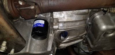

I am about 75 percent of being done with reinstallation. I have a couple of questions,
1. I had to remove the pitman arm from the steering wheel/ steering box. I could not get the driver side exhaust manifold in. If I remember prior to middle of July. I would have to put key in/on position to turn the steering wheel. After I reinstalled the Pittman arm back I can still turn the wheel with no key in it. The upper part of the steering/Pittman arm slid down a good ways. Please tell me I did not screw that up????
2. I got the intake installed and everything is where it should be. I do not know if this hose goes to the Yukon, my Mazda, or mountaineer. I keep parts bin for various vehicles and now it has me second guessing if I forgot to install this hose.
Getting a headache trying to figure the questions out above. Here is a picture of the hose in question. Looks like a vacuum hose.
