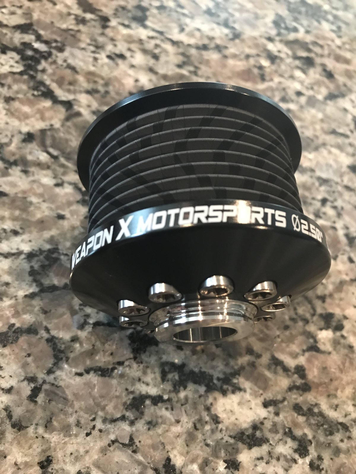

Received my 2.5" pulley today from WeaponX Motorsports. I've got some plans for the next 2 weeks that I'm very excited about. Building up an LQ9 iron block and pulling the Aluminum block. My Wiseco -20cc pistons will arrive tomorrow which will give me around 9.6:1 compression on the new 402" motor thanks to a Lunati Voodoo 4" stroker crank and Lunati H beam rods.
Total boost will be around 12psi with a stock LSA damper for now. New 8 Rib truck accessory kit from LSsimple.net will be installed to help with belt slip. Max boost will be 15.5 lbs should I upgrade my damper with an interchangeable overdrive ring. Can't wait!!!

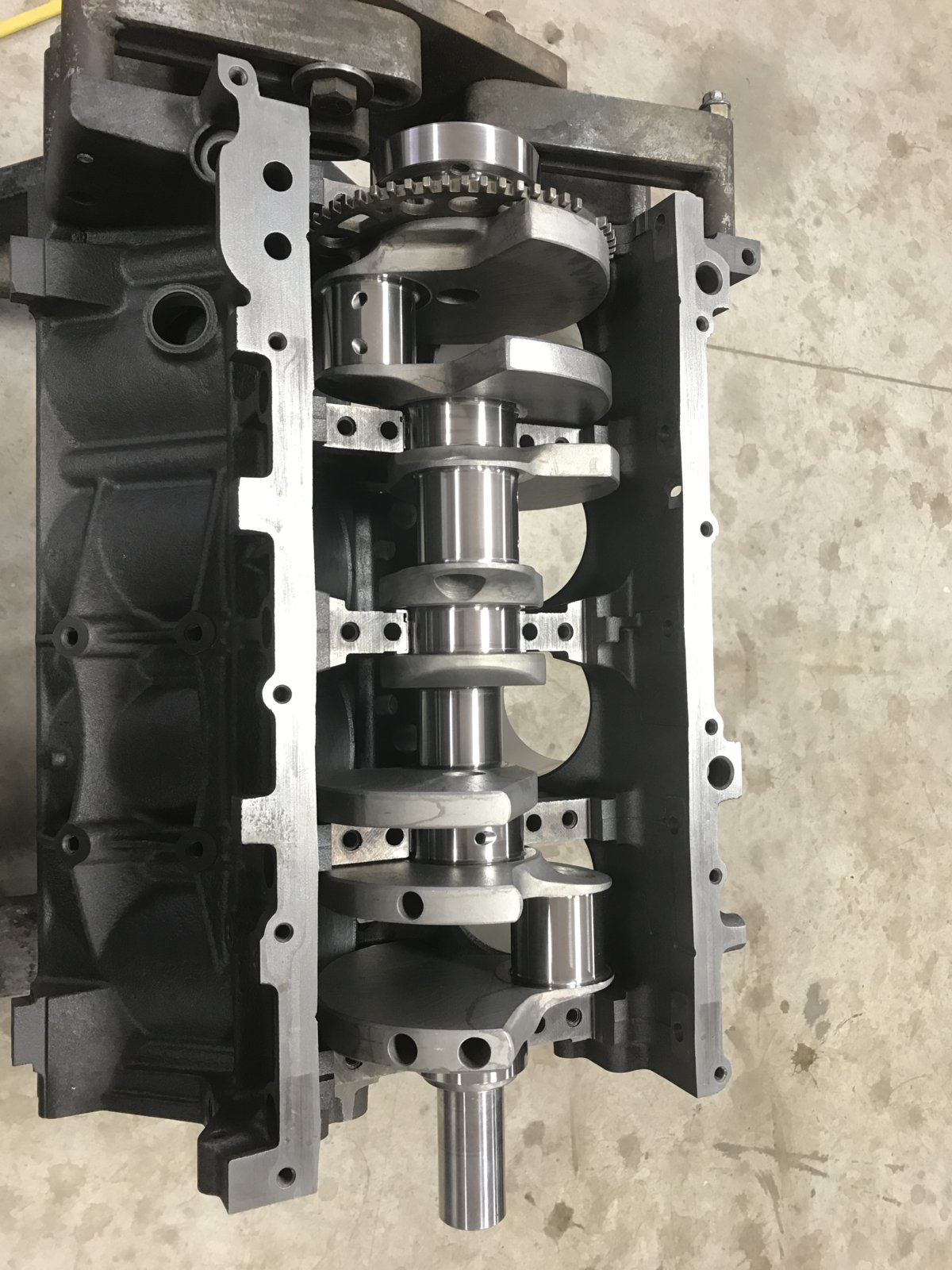

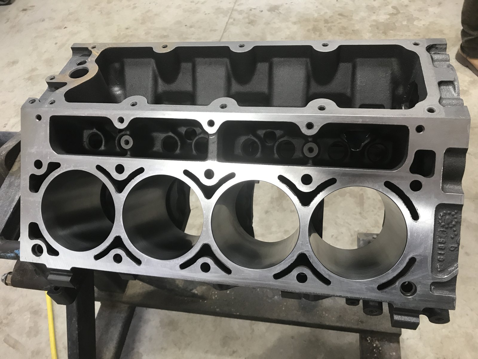

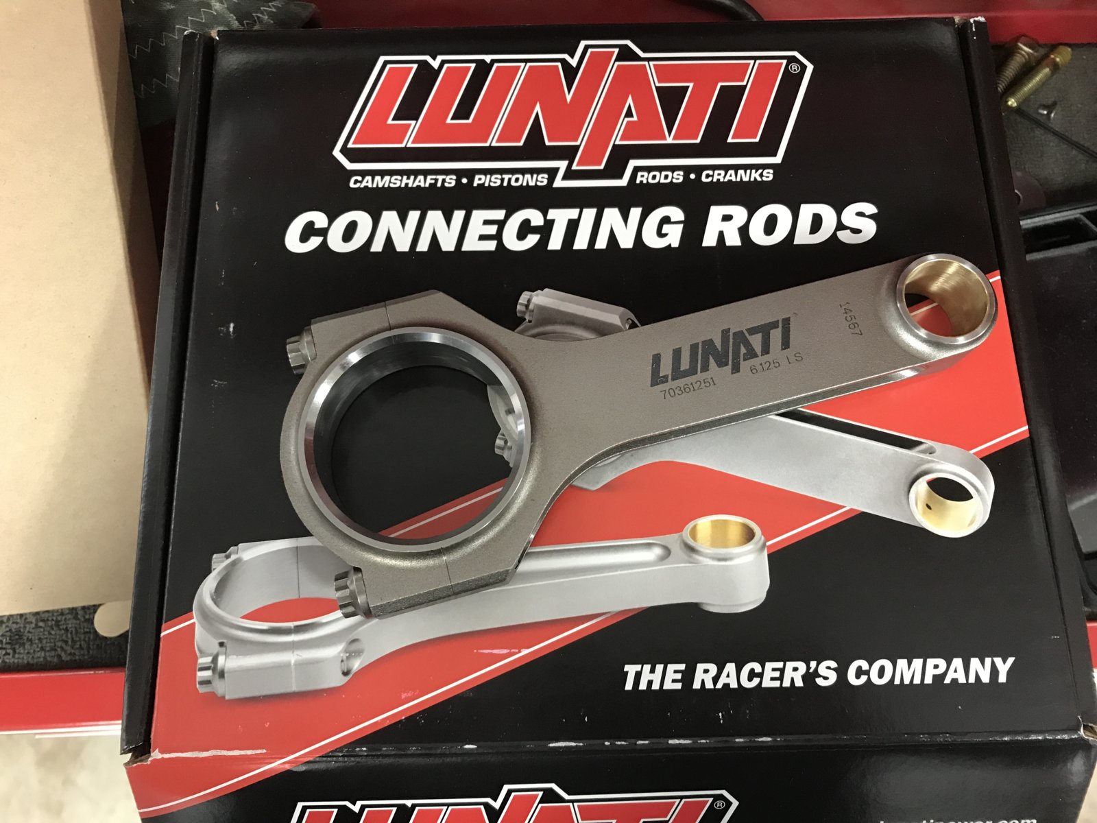

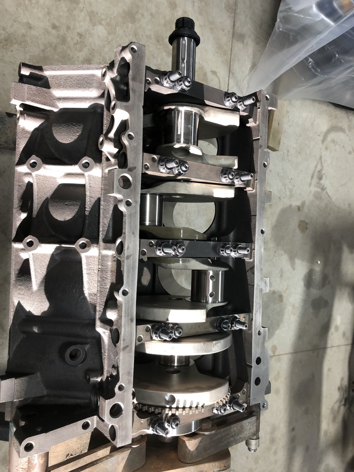

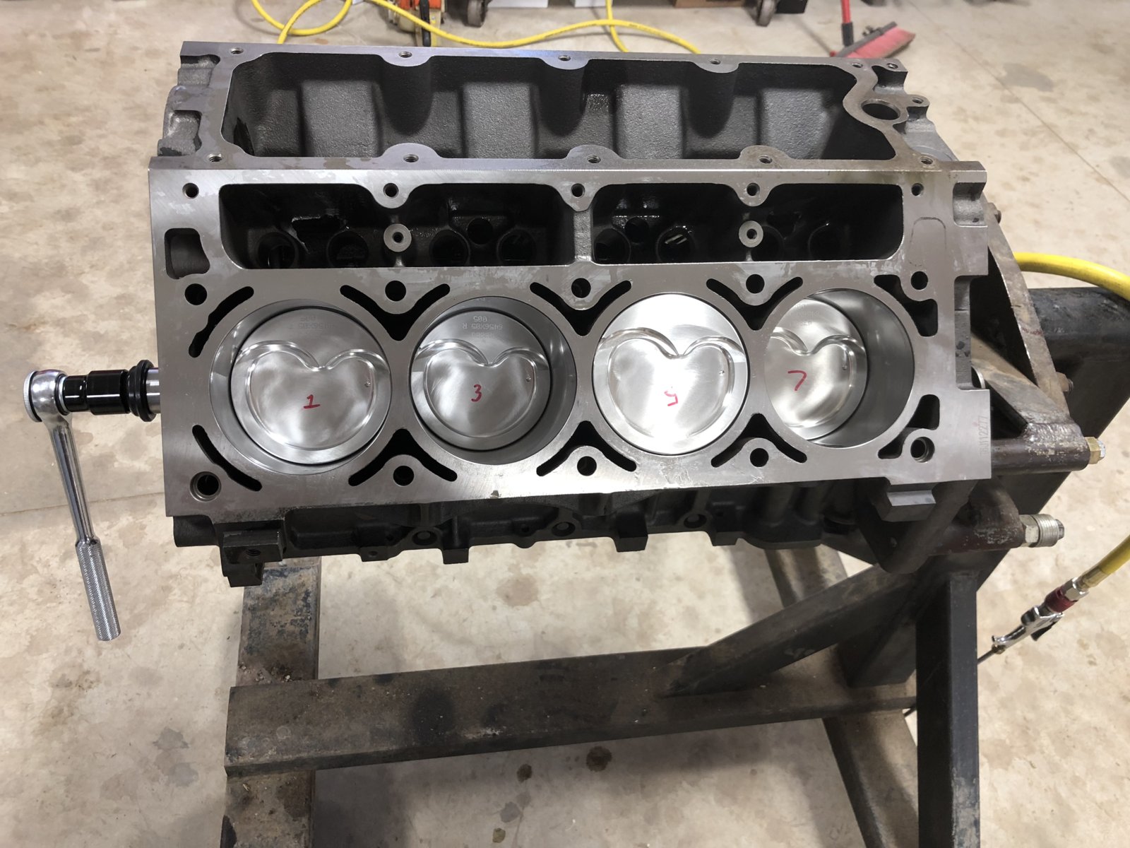

A little update from the garage... I got my 6.0 LQ9 block back from being machined. Rotating assembly is now balanced and I already dry fitted the pistons & rods to check clearance for the Lunati 4" stroker crank. The -20cc Wiseco Pistons, Lunati 4" crank and Lunati H beam rods are ready to be installed after a little more block deburring. Also have a Brian Tooley Racing Stage 3 PDS Camshaft, BTR Dual Valve spring kit with Ti retainers and a BTR Trunnion Upgrade Kit. Heres a few pics of the goodies and I will try to keep this build thread updated as I go. I have a 2,800 - 3,000 rpm stall Circle D triple disc torque convertor going in as well. The 402" motor @ 14psi should get me to 750 - 800hp. Also pics of my new LSSimple 8 Rib front drive setup... Very impressed with the quality, I wouldn't use anything else. Stay tuned!!!
