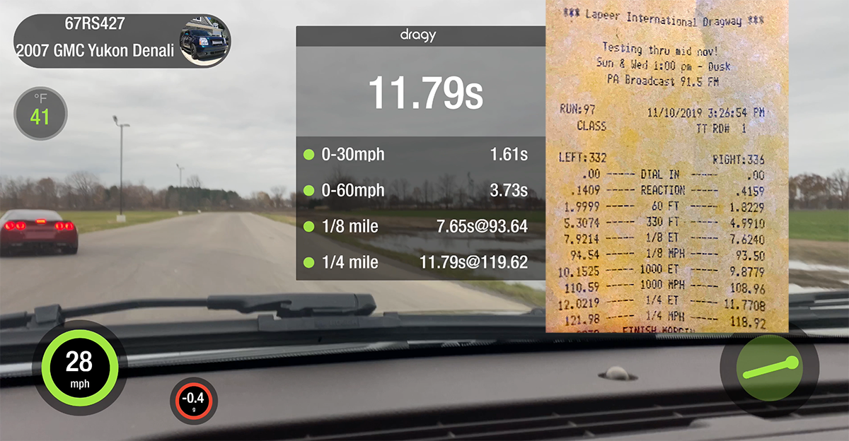

This will certainly get ran down the track this summer but it's a street truck 100%. I plan to tune on a dyno this time so I'll have some numbers from that as well... Expect a mid to high 11 qtr or so? My brother just bought a new Audi RS5 so my goal is to beat his $85k car to 60 (3.7sec) and 12sec qtr. Shouldn't be a problem lol
For my truck, whose racing weight is 6,300 pounds, in order to run 112 mph through the traps, the motor would have to produce 684 rear wheel horsepower. That would be around 12.0s with a good launch. You should have no problem taking down that Audi! What's its racing weight?

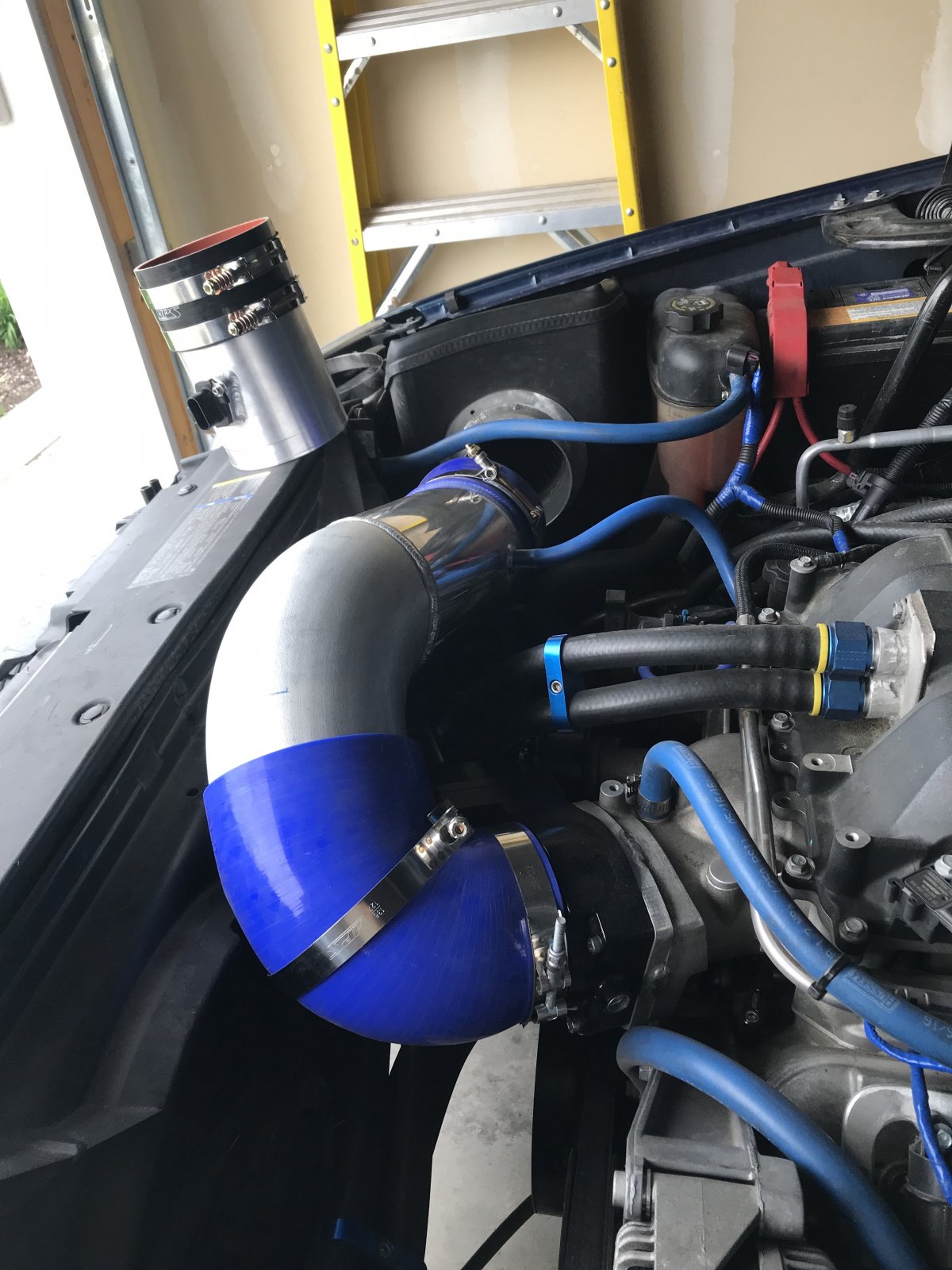

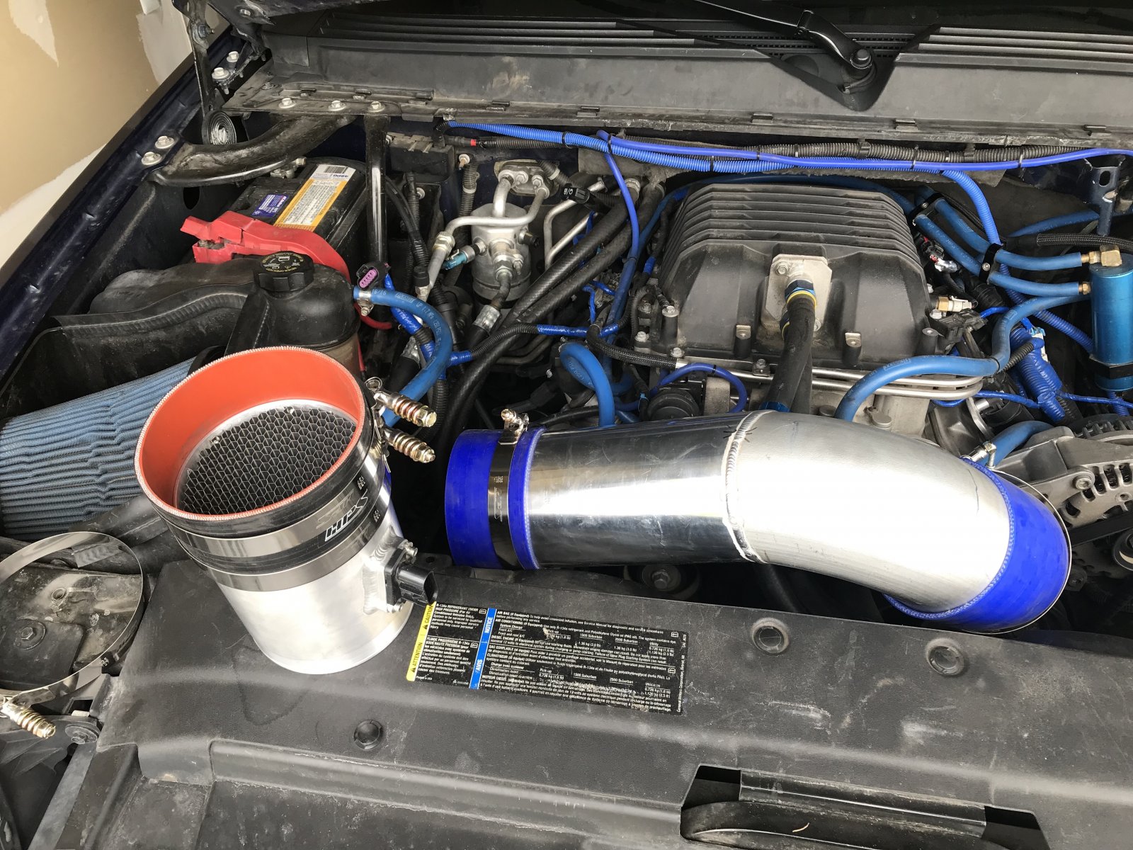

Snout - It's amazing how much material can be removed from these things. Easily took a few pounds of aluminum out of this thing. Opened it up for my 102mm NW TB and welded on an O Ring flange...
