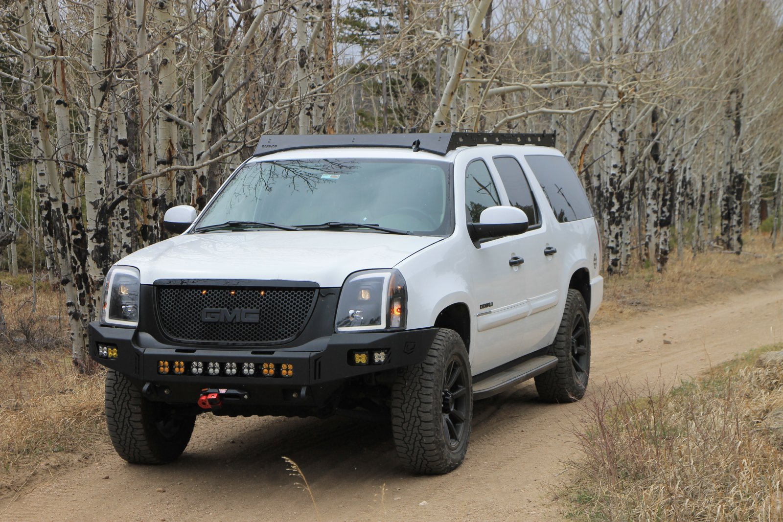

This is my set up. I am pleased with it. I previously had a suspension maxx kit on it that retained the autoride and magneride. it was fine, but my stock shocks and struts were quite old and I decided to go this route rather than replace with stock.
2007 GMC Yukon XL Denali
Icon 2.5 Coilovers at 2.5" lift front (71505) I really wanted to go the reservoir w/ CDCV route because I drive in really varied conditions and loads/ towing, but availability was really bad at the time, and they're pricy. I'm happy. A little harsh in town if anything. I only got to take them on a trail once prior to adding the winch/ bumper. Might need to change my springs for the added weight.
Icon 2.0 rear shocks (76526) - they aren't anything special. similar to Bilstein's. Rebuildable, but probably not worth it at the price point.
Cognito Upper Control Arms
Dobinson 2" lift rear springs (C09-045) - the stock coils with autoride are quite soft, if you delete those shocks you will sag. Moog springs and a spacer probably work just as well.
I added Air Lift helper bags for towing (you'll need 60912 or 60913 for Dobinson springs)
SDE magneride and autoride delete shockdeletes.com
