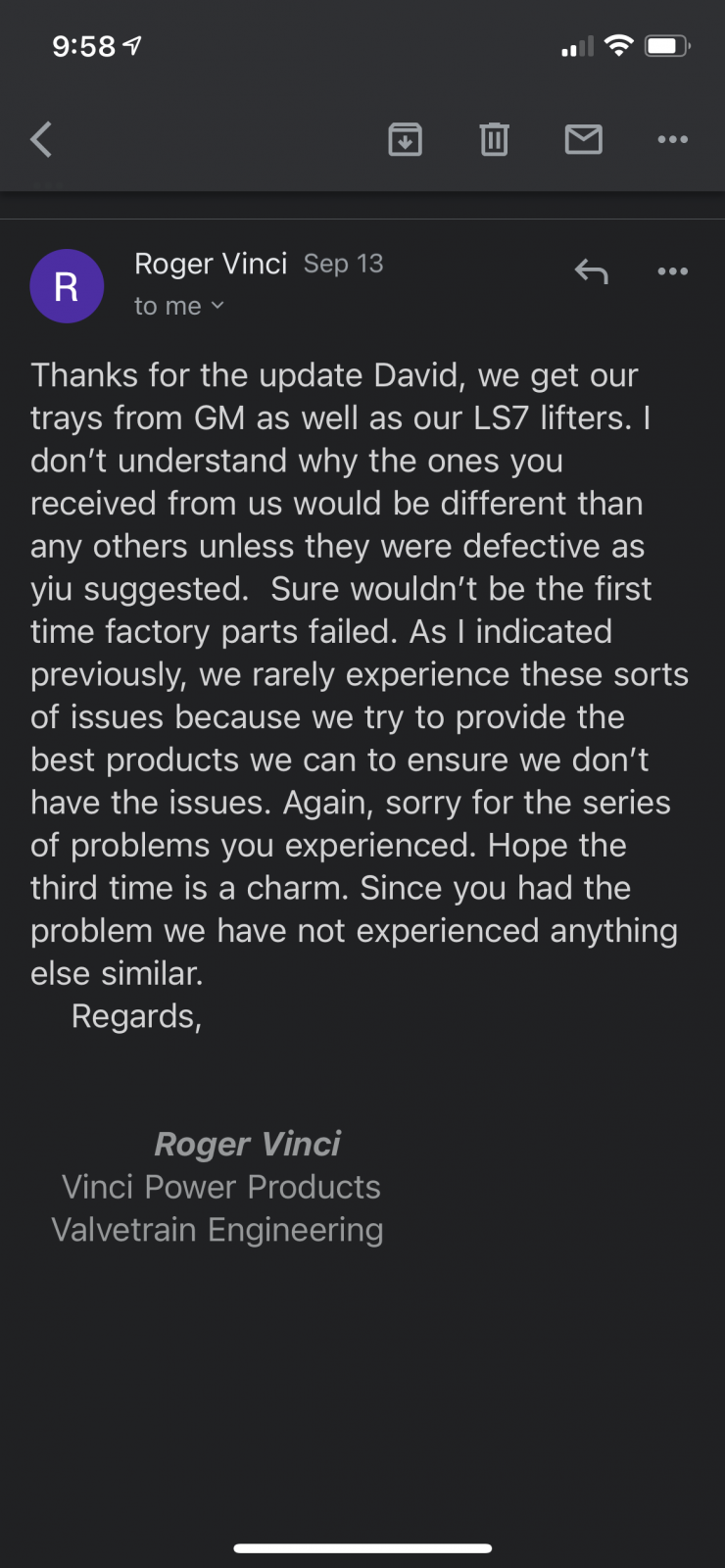

I heard from Roger this morning. He says he has cams with 100,000 miles on them that don’t look like this or have any detectable wear patterns. I believe him. In his opinion, this is classic lack of oiling issues, but even though the oil pressure was lower by about five psi than before the cam swap, it’s still well within spec for this engine. So I don’t know what to do next.
I cant find where you found the cause? The cam/lifters/stem seals/springs/retainers/pushrods you installed imo require no more "oiling" or a different viscosity than the cam and oem components you removed? If you cant find an installation error on teardown than i would not reinstall any of the divinci kit! can you compare oem /divinci cam journal measurements? Throw those lifters in the deepest pit you can find and replace with oem, are you certain there is no spring bind in your valve train setup? The wear looks like extreme pressure more than lack of oiling imo. you saw a 5 psi drop in oil pressure with the installation of the new parts, That should not have happened. We also tow a 4500 lb TT and i rarely see rpm in excess of 5k. Are you sure oem valve springs wont work? This rant hinges on the pick up tube o ring and the valley cover having no defect.
