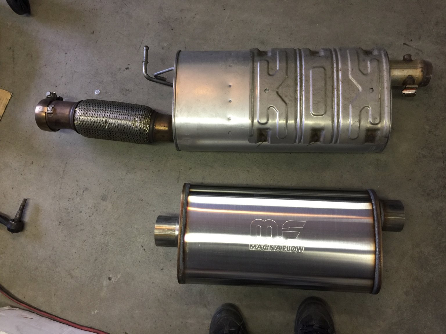

Thanks for posting the pics. I think I will go with the flapper delete.
That would be a good idea since it's 3" vs 3.5"

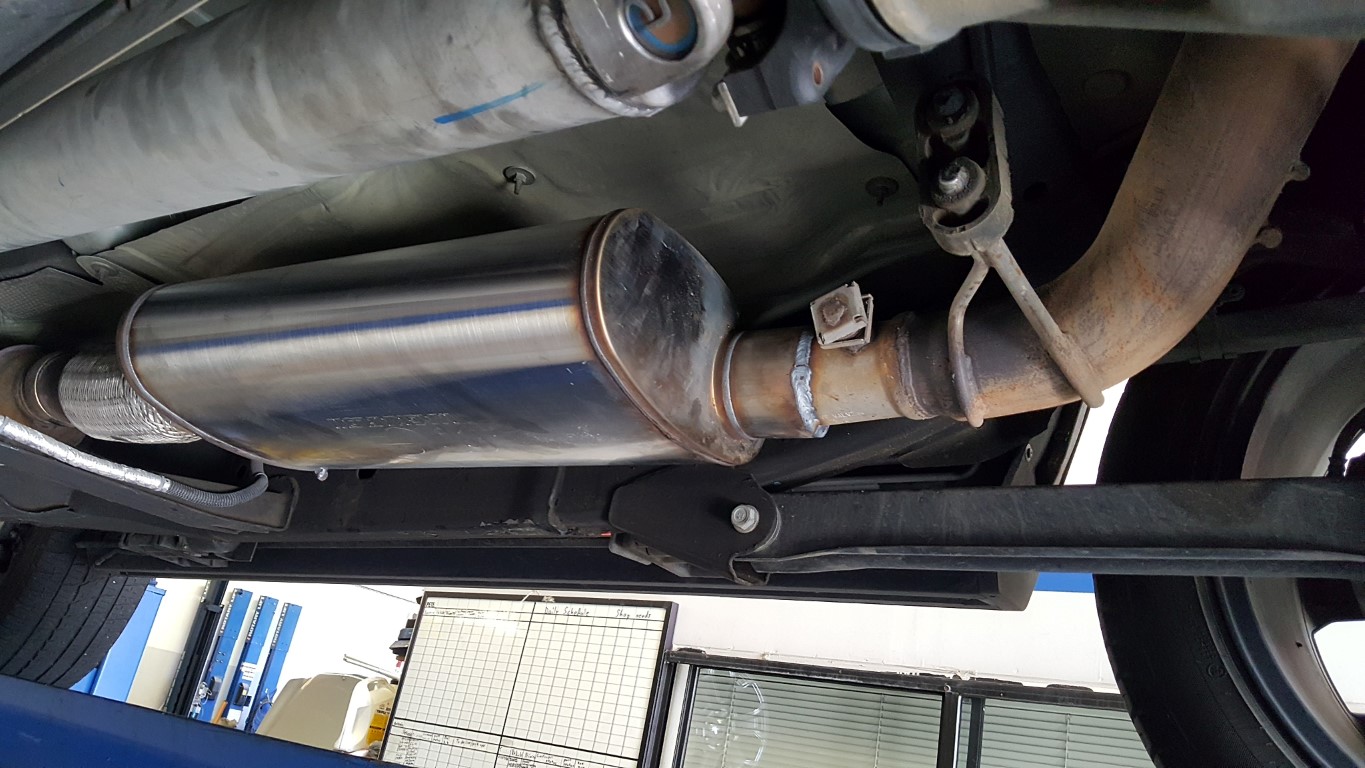

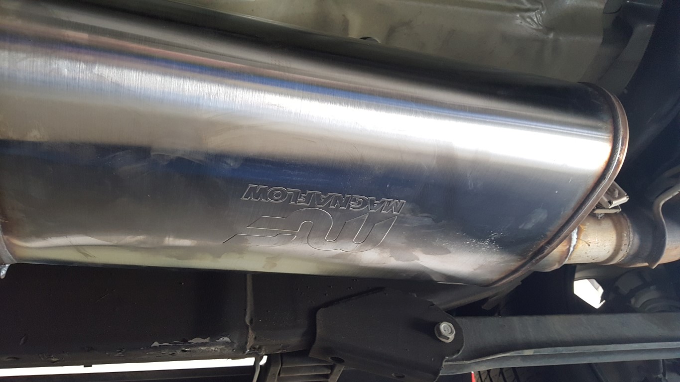

I would have to say the Magnaflow muffler paired with the AFE CAI is freaking awesome. I don't need a dyno sheet to prove its performance. It may be a placebo e ffect but I feel something good when I give it WOT and the deep sound it gives off... Its good!! As a matter a fact it blew my transmission!! 2nd tranny being installed at the dealer.

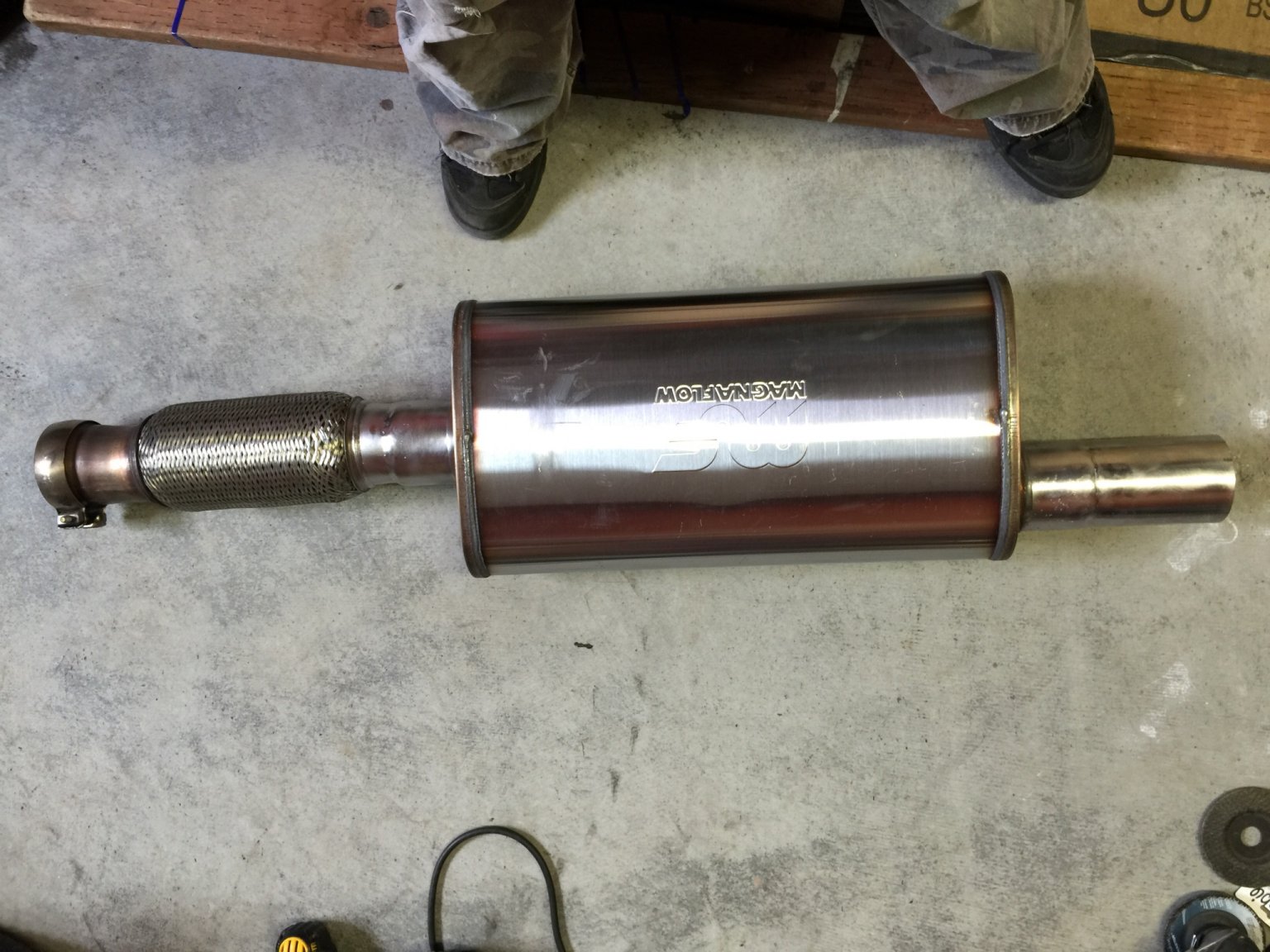

Very cool! I already have the AFE installed.
Just waiting on my muffler and a foot of 3 1/2 inch stainless so I can delete the flapper. It's strange how they did the stock exhaust after the muffler with 3" exhaust pipe. I'm guessing that's for V4 mode with the flapper.

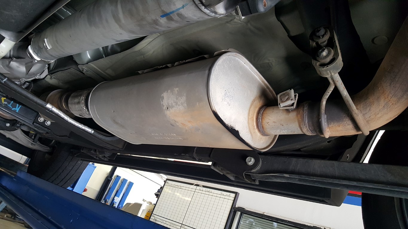

What is the factory oem exhaust tubing made of? Is it aluminized steel? I'm asking because I'm going to eliminate the flapper and the muffler shop doesn't have 3.5" stainless tubing. He said he can use standard exhaust tubing which is aluminized steel.
tbordenet
Nov 27, 2011
24
Pretty sure the factory exhaust is stainless. I ordered my 304 stainless 3.5" from Summit. I also used stainless mig wire to weld it.
