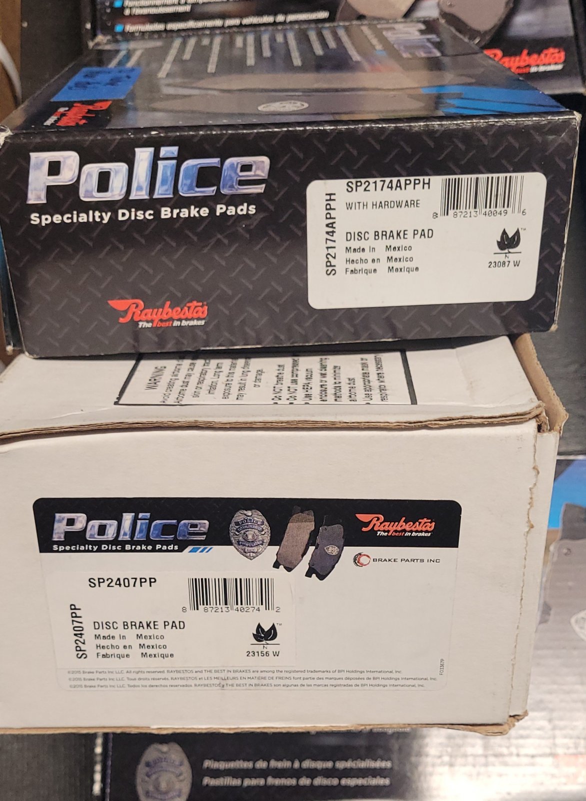

I lnow this is an old thread. Just thought I would add some info. Not sure if it will help.
On our 2021+ ppv tahoes we replace the factory pads with Raybestos Police # SP2407PP for fronts and # SP2174APPH for rears. Available at O'Reillys. I dont recall cost of pads but I dont recall them being super expensive. Replacement rotors in the Raybestos Police are about $100 each.
Side note, I read through these posts and dont recall what was needed to mount the ppv caliper to the spindle on an 05 Tahoe. Maybe another thread that goes more into detail on the gmt800's. I haven't searched that section yet. Thanks!

Really, its that simple. Thanks for the info.
Doing the PPV brakes on my 2021 Yukon Denali XL. Got the Raybestos pads and rotors for the front and rear. Threw the rear brakes on and they're nice and quiet. The fronts w/ PPV Brembo calipers will go on in the next day or two, and I'm sure they'll be nice and quiet too. Thanks for the part numbers and info!
