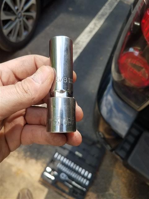

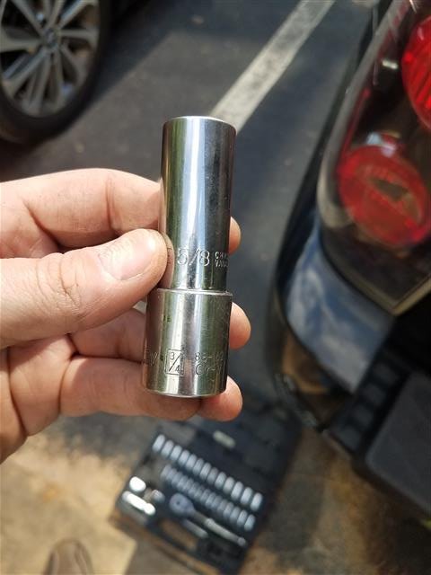

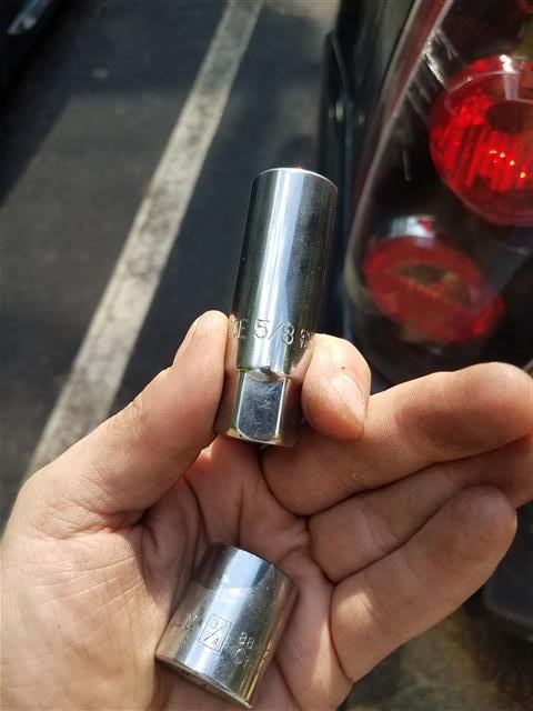

It’s the best way. Regular plug socket with a 3/4” EXTENSION on the end, which Im pretty sure @Hi-psi meant
I've always used a 3/4" regular (not deep) socket on the back of a 5/8" spark plug socket. This probably ends up being about the same as having a 3/4" extension. But, most any mechanic's tool set that includes a 5/8" spark plug socket is gonna have a 3/4" socket before having a 3/4" extension in the assortment.

I wouldn't BS you!
Just measured: My Craftsman 5/8" spark plug socket is 2 3/8" long. With a Craftsman 3/4" short socket on the back of it, the combined length is 3 1/8". All 3/8" drive.
I just checked, same here. With the 3/4” extension instead of the socket the total is 3 5/8”. Either method will work so now we have more ways to do it. With my headers though on The Beast I now have to pull the fender liner and go from below. But on the Silvy I can still do it from above.
