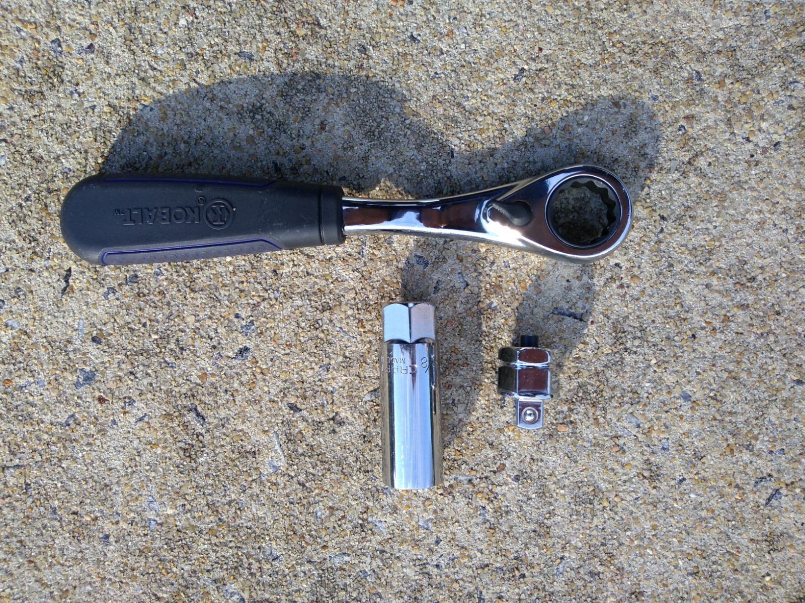

It’s the best way. Regular plug socket with a 3/4” EXTENSION on the end, which Im pretty sure @Hi-psi meant:
Or maybe not but a 3/4” extension with a regular plug socket does work best.
No, actually what I meant is what I said. A regular spark plug socket, with a short well 3/4" socket on the end. Adds just enough overall length to put your ratchet point just past the manifold.
20190521_171500 (Small).jpg 20190521_171515 (Small).jpg 20190521_171518 (Small).jpg
