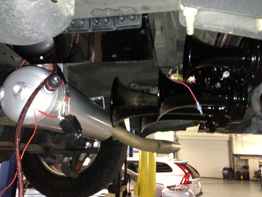

stereodesigner
May 1, 2012
126
Someone else also told me the inside of the frame rails. Think that's where I'm going to put it. Thanks man!
How did you mount it there(strap it?) what materials did you use?
And did you go through any serious water?
Also where was the tank mounted?
Thanks again everyone for the input.

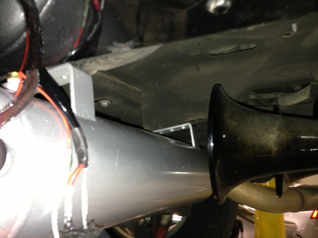

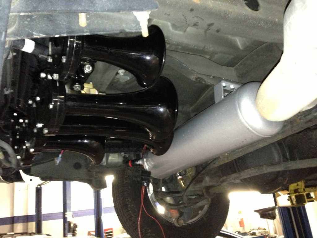

I mounted the horns with a heavy duty backstrap from Lowes (or any hardware store would have it I guess)... I never sunk them in water but they did get some mud/water in them......if they get soaked they will sound clogged gonna have to face them down to drain the stuff out of them or let them dry on their own for a day then just lay on them it usually worked lol...
If your only getting one set you can either mount them in the grill somewhere away from water or you can mount them under neath facing backwards
Greg
Thats alot of horns. Overkill lol
i know I have a self Control issue at times
And what type of compressor is that in the pic? And how many gallons is the tank? Probably just stick to a 3-5 one.
Saw someone selling an 11!!!
Greg
I'm pretty sure it was a 5 gallon tank...and I just bought a heavy duty compressor from horn blasters

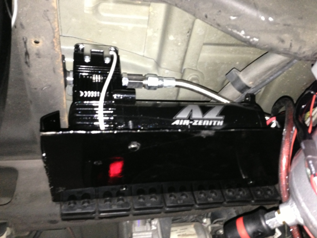

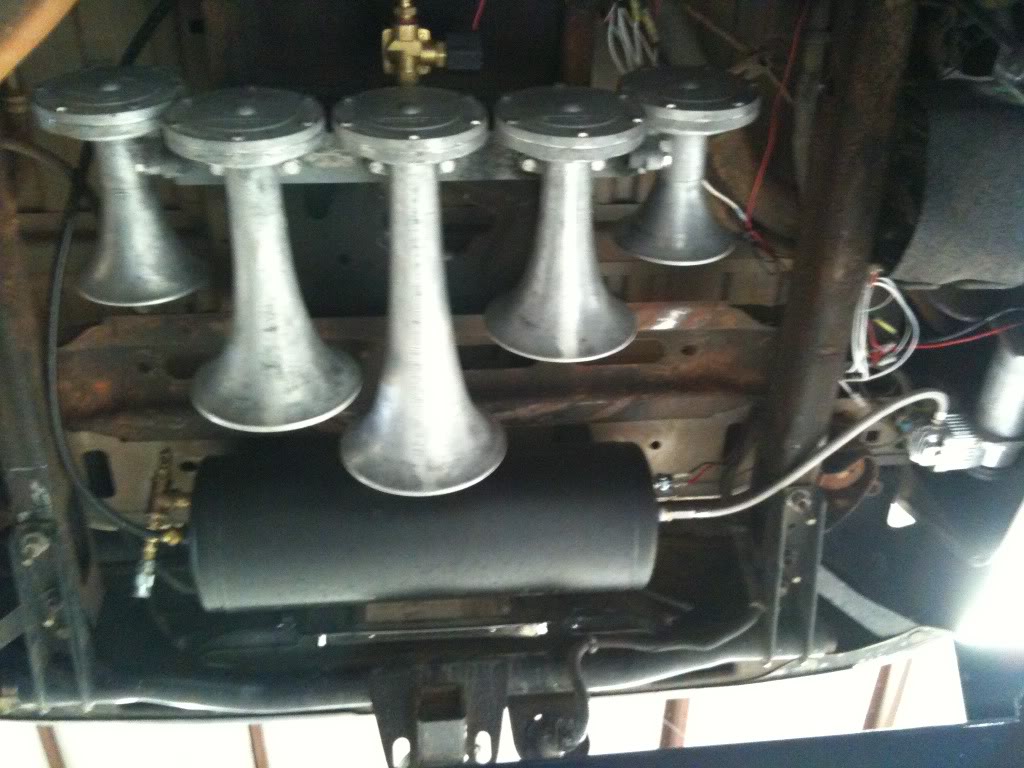

I got them on my yukon were the spare was mounted. I have 2 two gallon tanks mounted to the frame and installed in series with one Viar 400 compressor (i think). The compressor is mounted on the passenger side frame behind the rear tire to the body side. The horns are mounted in the grill facing down to the ground. Its pretty loud and lots of fun when people are walking outside or when a driver needs to wake up on the highway. I will try to upload some pics to explain how they are mounted.
