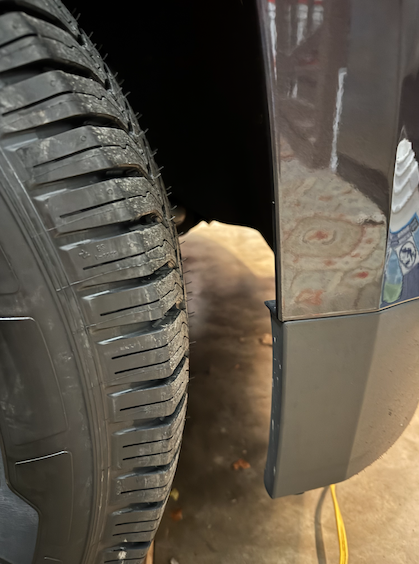

For future readers of this thread (hopefully some more 3500 owners will come along, too!), the factory tire size is 265/70r17. But 275/65r18 fits great. They're a half inch bigger in both diameter and width, but they fit fine with no rubbing. The factory wheel offset is +44, which matches the factory offset for most newer GM pickups with the 8x180 bolt pattern. Lots of good deals out there on OEM 18" wheels in different styles. I've only had them on for a few days, but the ride is unchanged with the 18" tires, as far as I can tell.
