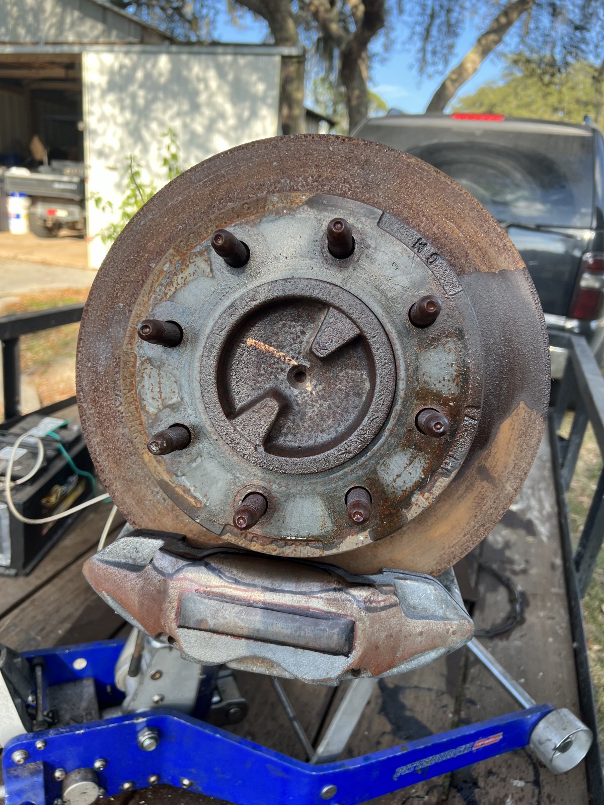

youve got a gift alright.... :cheers:
looks like the pinion says LH100 = left hand? meaning rear gear cause a front 9.25 needs a RH iirc
then 11x41 under is for the teeth count
guessing the other etching is prob just who ever built it, they put some shit on there so if you blow it up and bring it back to them they can confirm that no one messed with it, shims used something like that
the teeth looks like they ate something

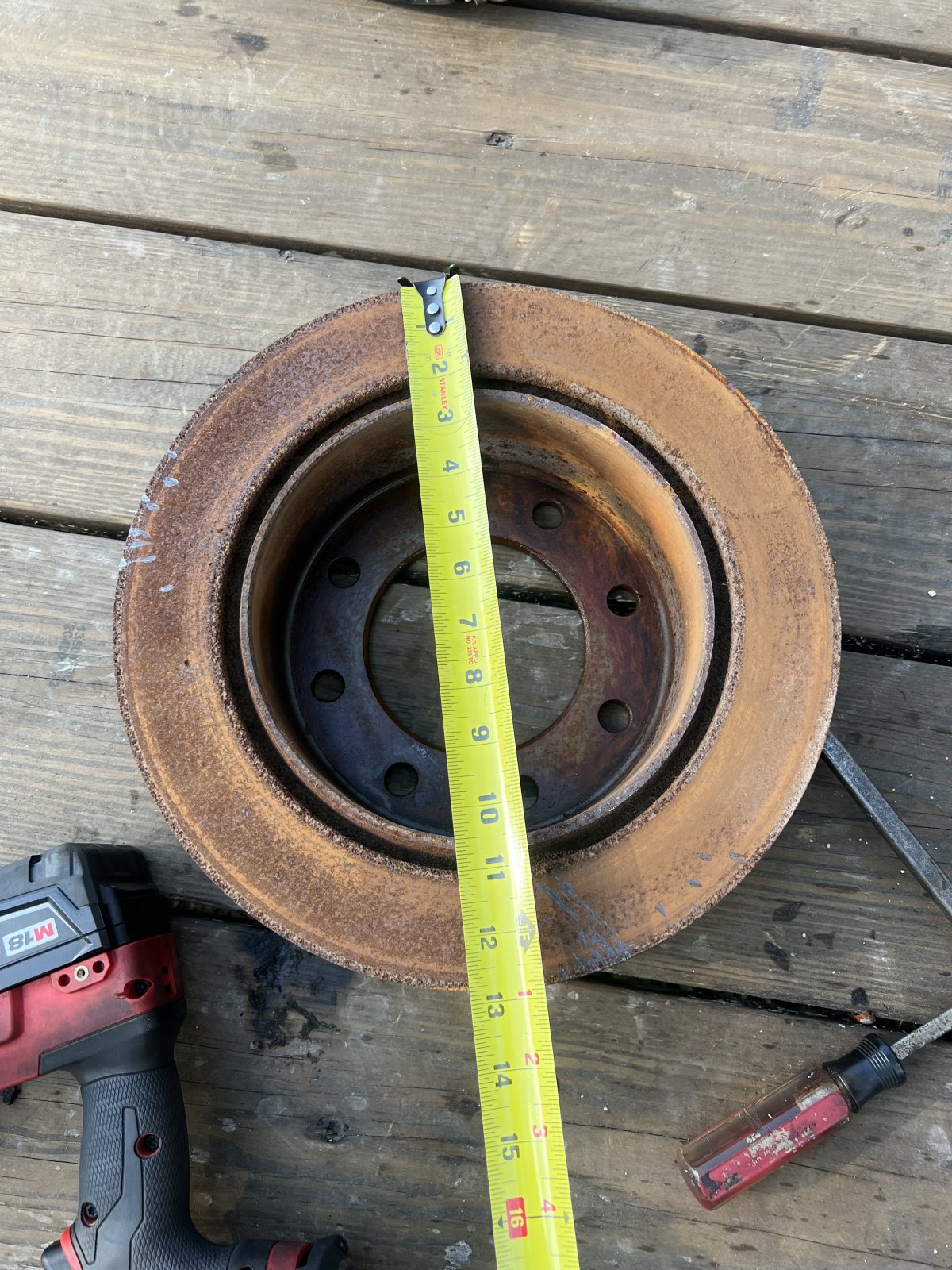

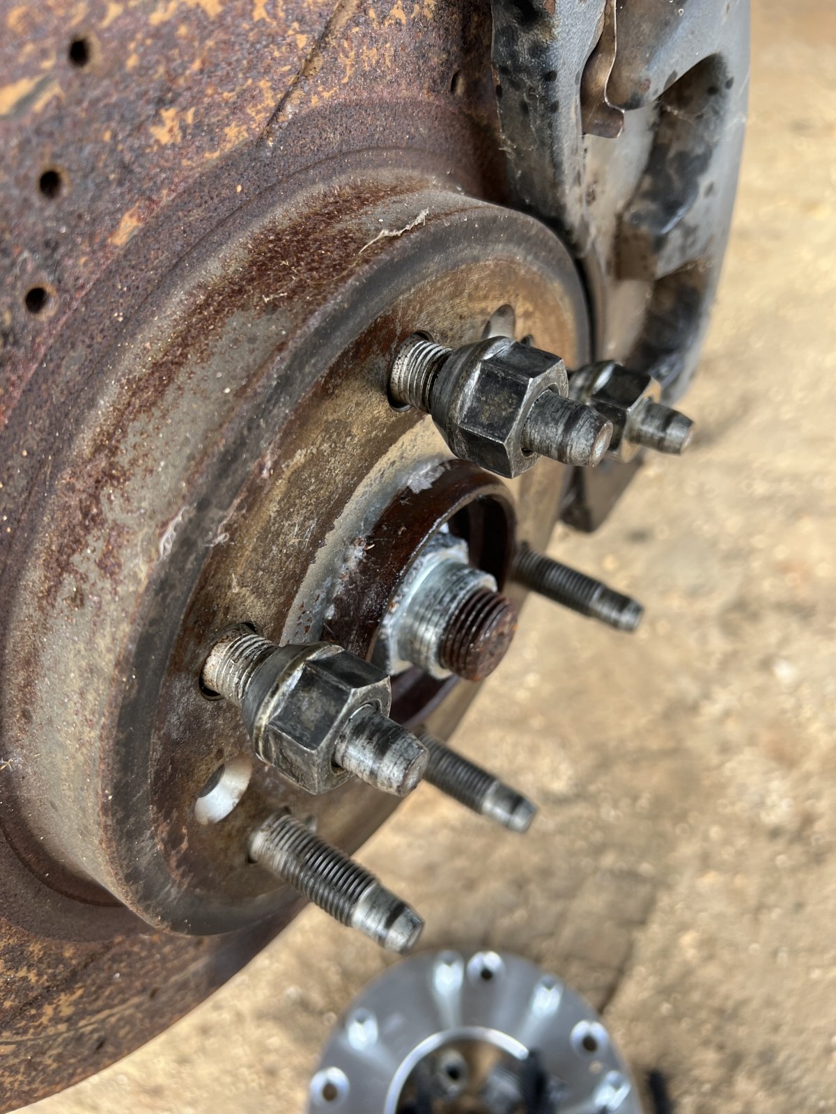

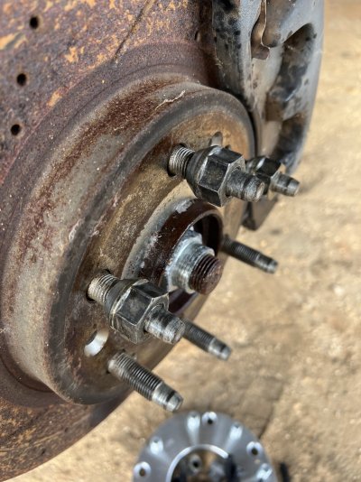

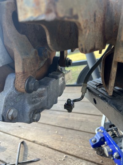

nnbs 10bolt and 14bolt I swapped my rotors and calipers over when i swapped, but you'd prob need to know how far from the end of the axle tubes to the axle flange is to see if you could use all of the hardware
Nice hieroglyphic interpretation I didn't think about the Left hand part I like learning little bits like that. My personal thought on the initials is that RK means ready to kill...... tires that is.

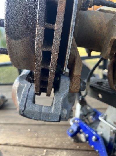

I think before I pull the trigger on a Power stop kit or whatever from online I'll get a setup from autozone and check fitment. Then return it when I'm done mocking up. 99% sure it will all fit fine once the spacers come in but better safe than sorry.
Not looking forward to pulling the C clips and axles out of that 10bolt again. Not sure why It was so much more difficult than with the 9.5s but it sure was.

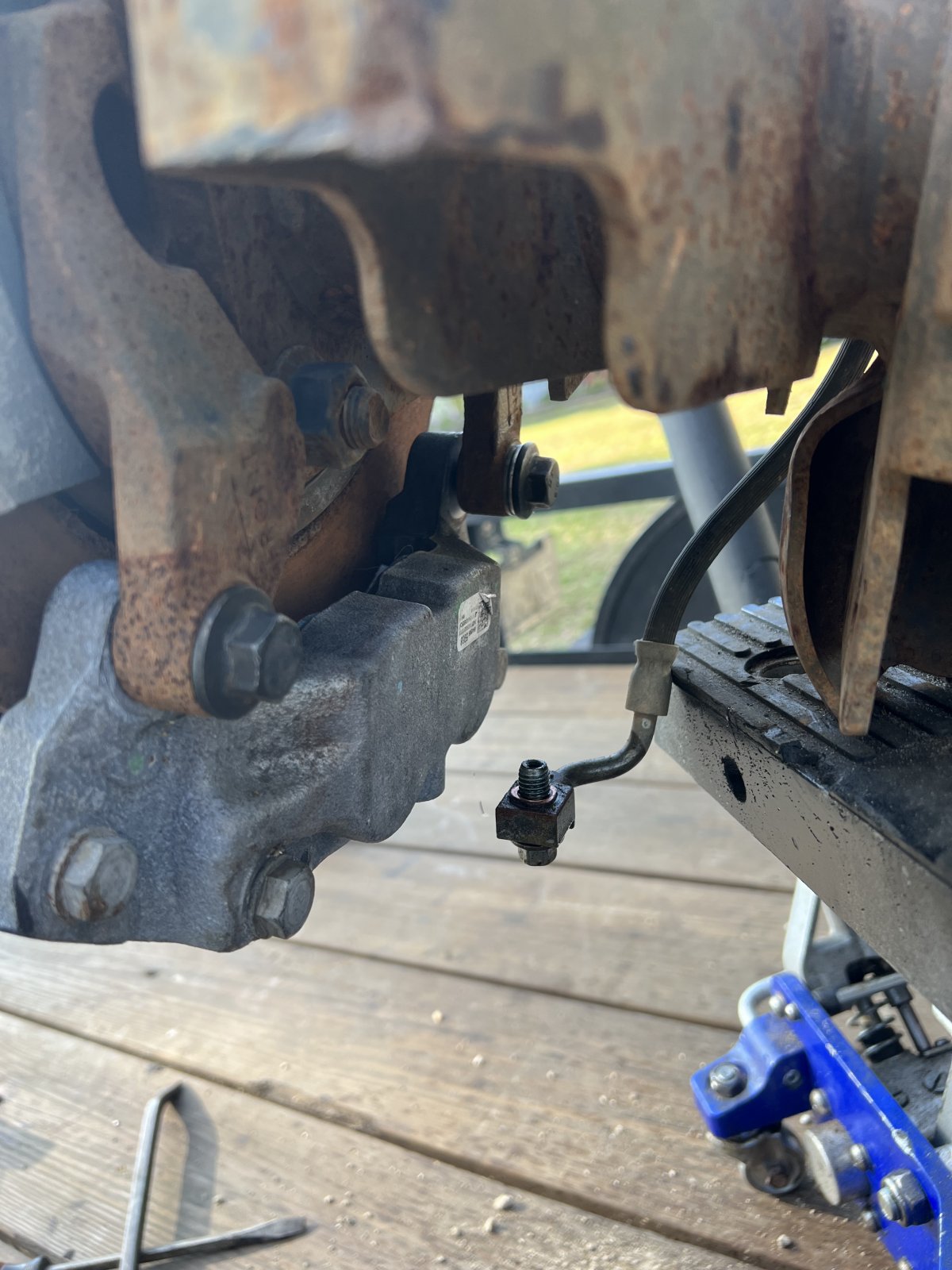

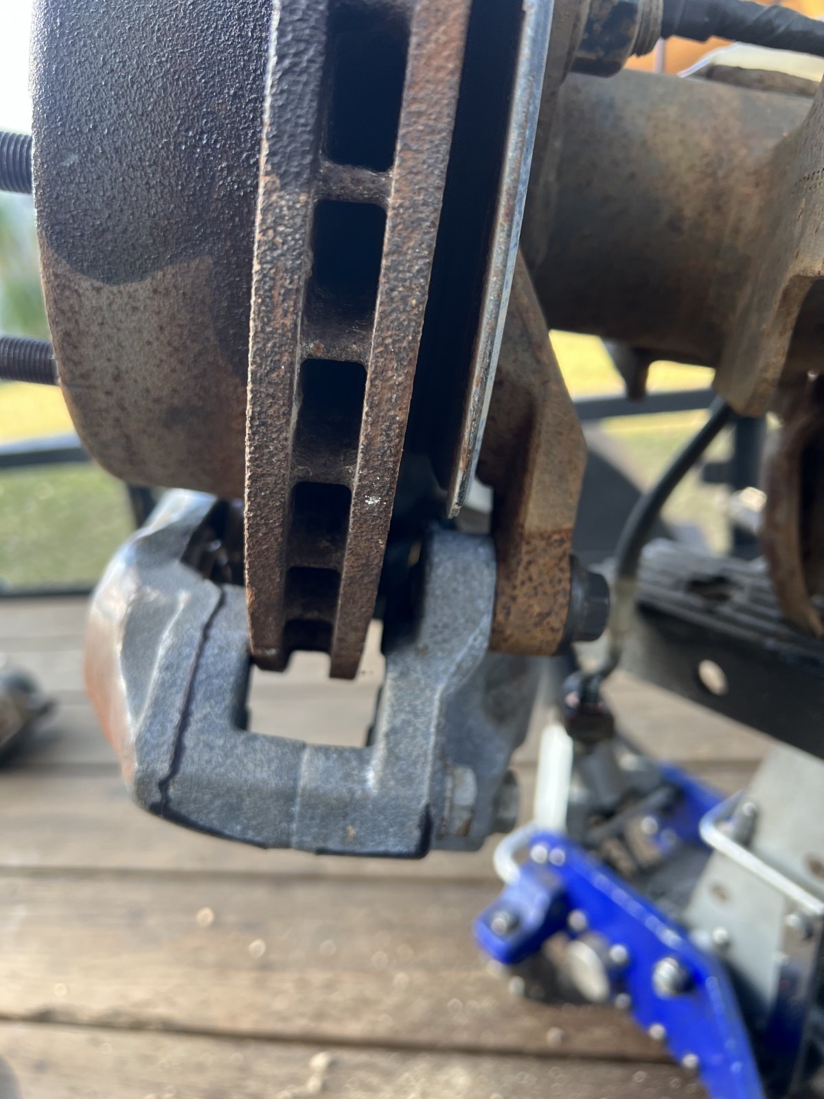

New theory for the brake swap. So when I did the Hybrid 9.5sf in my Tahoe I ended up using the original 10bolt brake backing plates because the 9.5 backing plates had a slightly larger diameter heat shield and it wouldn't allow the rotor to seat completely. Therefore I put the 9.5sf backing plates back on the 10bolt and gave it to a neighbor who ended up throwing it in his scrap pile and not using it for a 4x4 project like he promised.
Long story short I need a set of backing plates to put disk brakes on this rear end so I think I will go steal those back from my neighbor (granted its still in the heap) and then order a set of rear disk brakes for a 2011 Denali.
Things to figure out:
-Is there any difference between brakes for a 2011 Denali with a 10bolt vs with a 14bolt?
-How the heck will I figure out keeping the E brake.
-Whats everbody's favorite NNBS rear brake setup?
*Edit*
-According to Powerstops website there is no brake caliper, rotor, or pad difference between NNBS SUVs with a 10b or 14b
-However according to Powerstop there is a difference between NBS and NNBS rear disk brakes which seems obvious, but the difference is only the rotor itself not the pad or caliper.
Not that this is really useful info but info it is.

Got the brake brackets and heat shields off the old junk axle last weekend. The brackets are in good shape but the shields are pretty bent. Might buy the 2 piece ones or just beat them straight. Noticed there is an adjustable ring on the passenger side of the housing. Not sure if this helps you get everything shimmed just right or what I guess I need to do more research because I don't remember seeing this on the 10B or AXN 14B.
Waiting on brake bracket spacers to come in before I can mock up brakes and I think Atomic Fab & Perf has a set of shock relocation mounts for the 3 3/8" tube which knock another item off my list. 20200815_192140.jpg 20200815_192223.jpg
