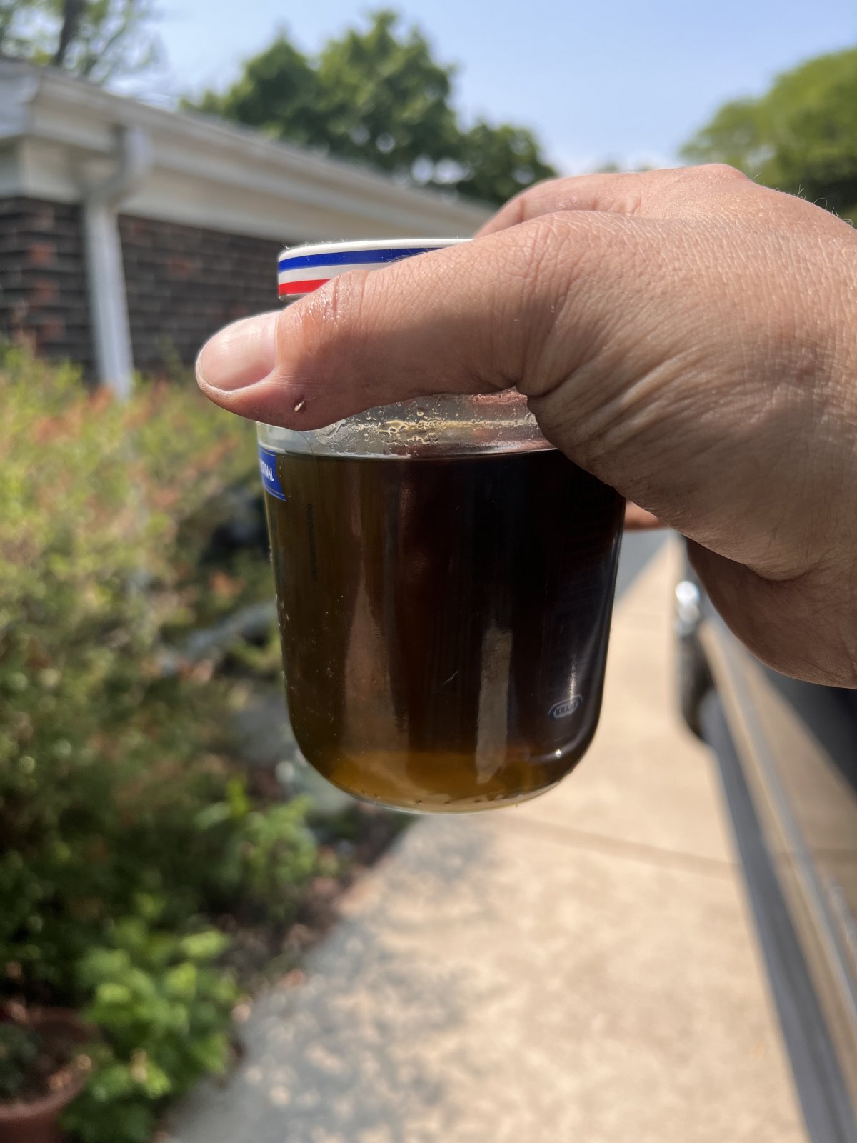

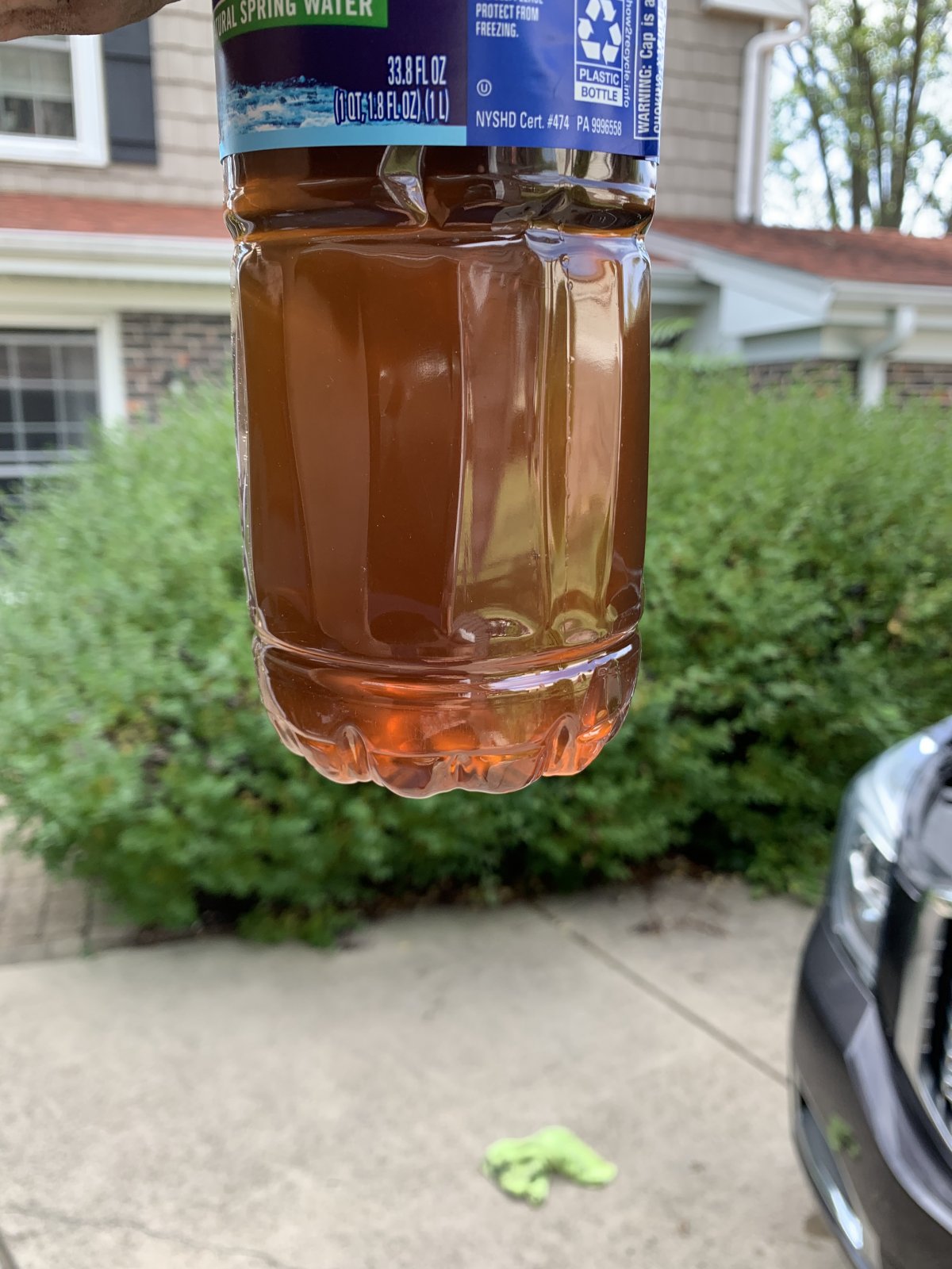

OP here with update.
It’s almost exactly 1 year since the first full system flush. Now at 70k and I put new rear rotors and pads on, flushed again on rear calipers:
Fluid gets dirty quickly.
I put front pads and rotors on at about 60k, and flushed front calipers at that time.
I think I’ll do annual flushes going forward.
Take it for what it’s worth. I like clean fluids in my vehicles.
Have a great day!
