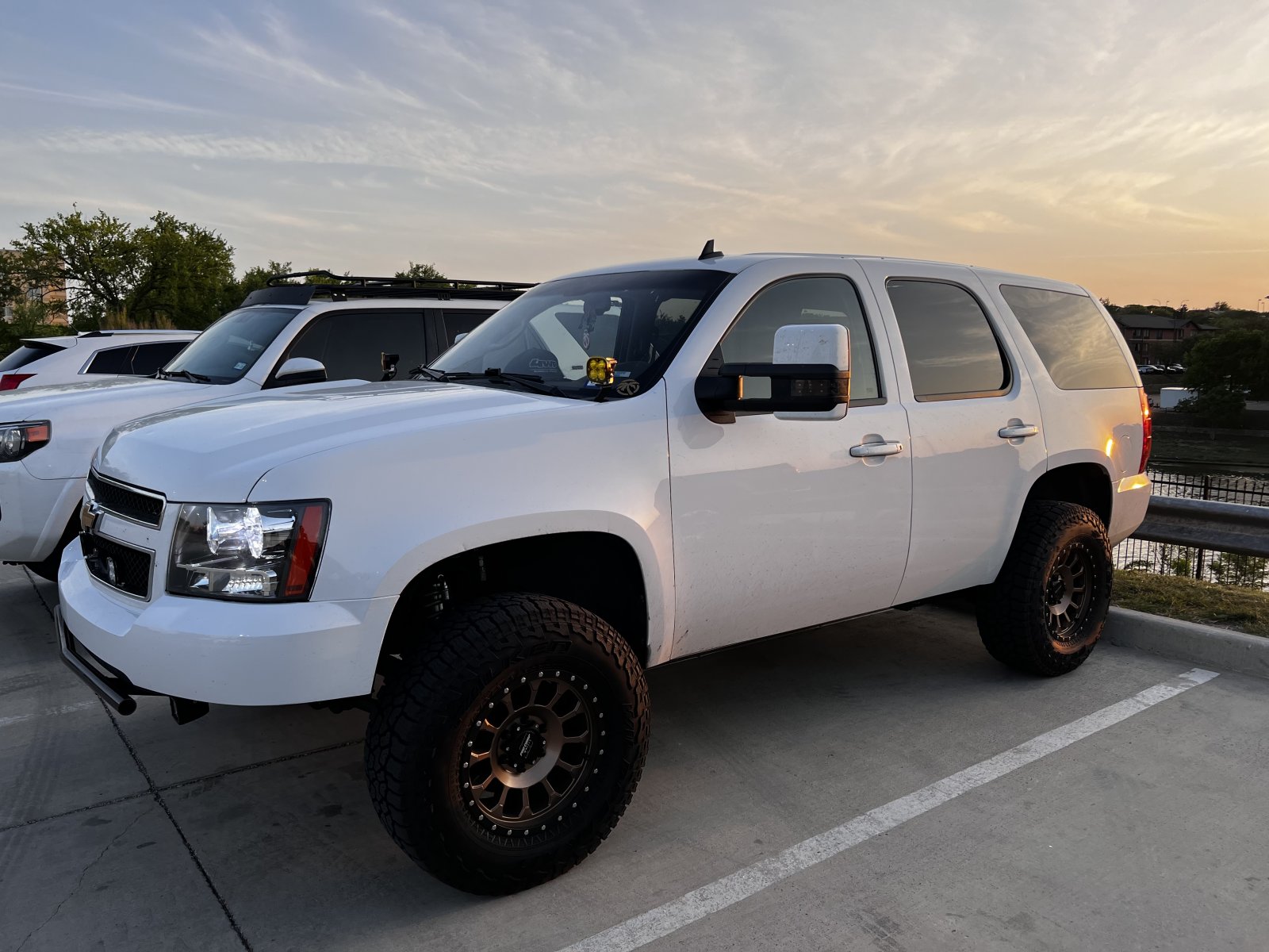

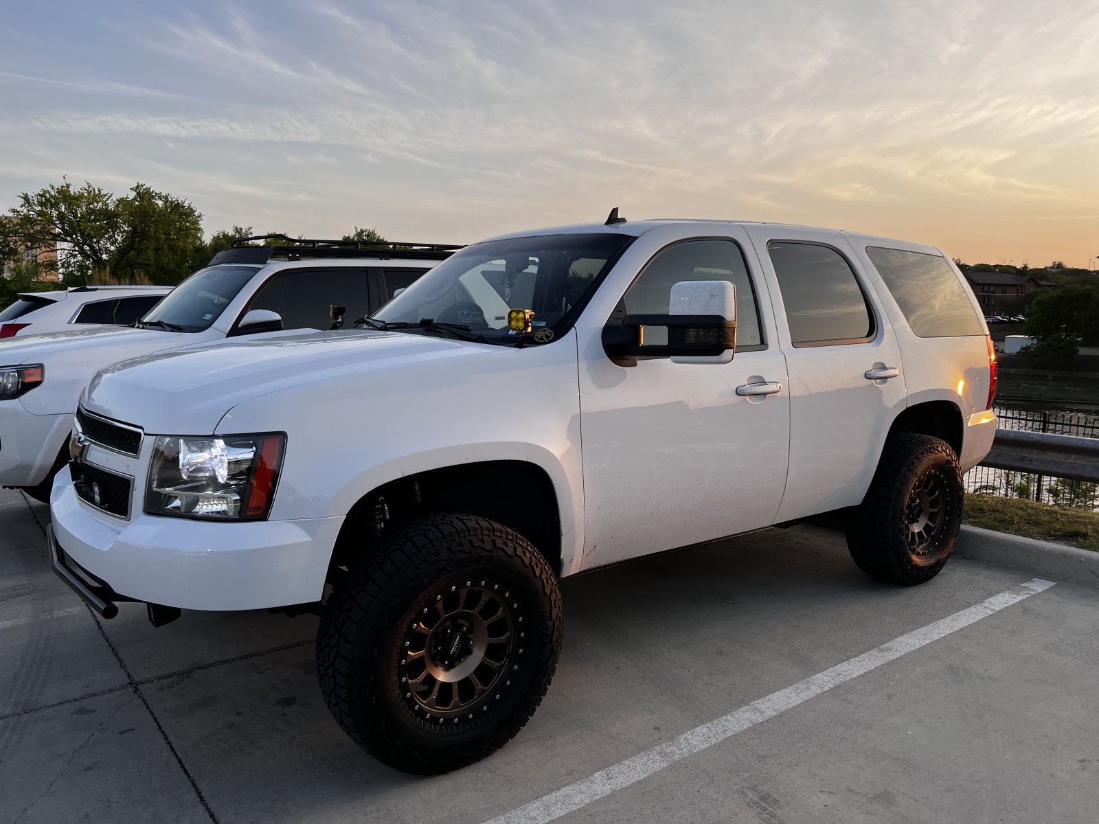

Fiberwerks fenders! This is the kit I’ll be ordering soon

Nice, definitely post up when you get them.
I saw those on Instagram. They look pretty slick.
