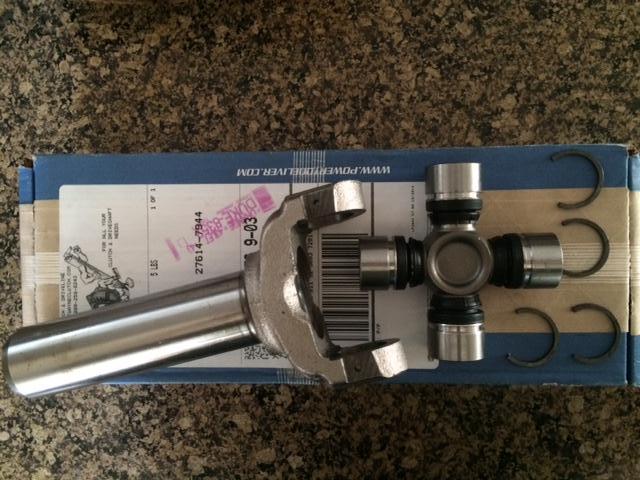

And this slip yoke is for 2007-2014 Yukon/Tahoe?
---------- Post added at 07:21 PM ---------- Previous post was at 07:09 PM ----------
That's the same one I got.
I also got the tail shaft housing with bushing = 24241496
& u-joints = 23104840.
Doing this eliminated the clunk for me.
What a lot of people seem to neglect with the clunk is the bushing in the tail shaft housing does wear over time.
I like the price of the nickel plated one.
Are those the part numbers on the fort wayne clutch site? Didn't find anything by searching on them.

Called Fort Wayne Clutch and apparently there are 2 slip yoke choices. One with inside snap rings and one with outside snap rings. Have no idea if that is something I can identify just looking at the slip yoke in place. :confused:

I don't recall the yoke having any type of snap ring at all.
I found the housing with seal for $51.52 delivered
And the u-joint was $48.09, I only bought one online. I ended up buying another at Oriellys for around $25.
BUT, you can find u-joints at your local parts store for a lot less, around $50 for two of them. If you go that route, make sure to buy the ones with zerk fitting and not the pin hole greaseable joints.
If you google the part numbers, you should be able to browse through and find the least expensive seller.

My new nickel plated slip yoke + u-joint is on its way from Fort Wayne and now I am looking to order the tail shaft housing.
